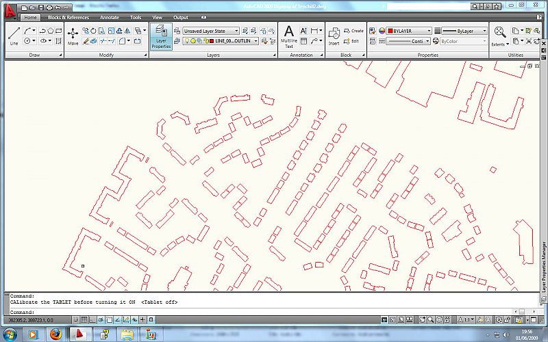

Hello! I'm just trying to get a ratio of housing to land in an area. I've got the houses shown and I have regioned them all so they are not just seprate lines, how can I quickly measure the entire area of these regions. I know of the area command, but with that you can only add individually and I have about 4-500 buildings to select.. any ideas on a quicker way?
I've found it, the 'Massprop' mass properties command gives you a totalled list of areas and perimeters of all the objects selected if they are regioned and allows a drag selection :)
