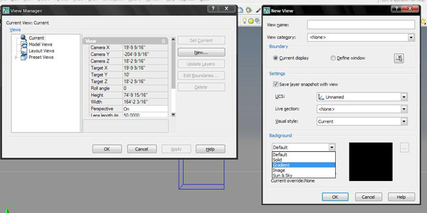

Nick@TE-Direct Posted May 21, 2009 Posted May 21, 2009 Hey guys, whenever I try to use the gradient background in 2009 it meshes with my object and makes the object very difficult to view. Anyone have some tips on how to use the gradient background? Thanks in advance for any of your help. Quote

papagyi Posted May 26, 2009 Posted May 26, 2009 ၤFirst you should save your perspective view then you can choose gradient for background drop down from new view dialogbox !...check attach image! Quote
Nick@TE-Direct Posted May 26, 2009 Author Posted May 26, 2009 I understand how to set the drawing for gradient, my problem is when i go to render the gradient is actually meshed in with my object and I am trying to figure out how to fix that Quote

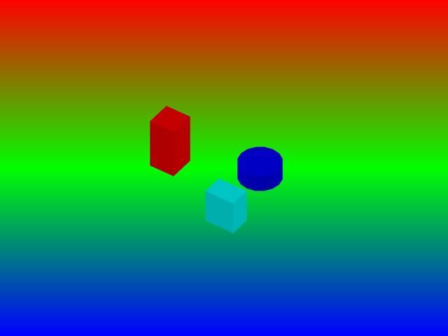

papagyi Posted May 26, 2009 Posted May 26, 2009 ok..can you post screen shoot your meshed render? Quote
papagyi Posted May 26, 2009 Posted May 26, 2009 You should make plane under your objects!Plane size is depend on you what you want to show. Quote

papagyi Posted May 26, 2009 Posted May 26, 2009 This may be graphic error.First check "3dconfig". If not ok,open new file with copy & paste! If will get still problem,you must create plane under your objects(means..surface floor plane or solid floor plane).Then you will need to make gradient material and apply to this floor plane! Quote
Nick@TE-Direct Posted May 26, 2009 Author Posted May 26, 2009 so the way you were able to make the above image with the objects on top was by having a solid behind with a gradient material? It just all seems a little more intense then in simple 2002 where I could just add the gradient background and it was done. Quote
papagyi Posted May 26, 2009 Posted May 26, 2009 Right fri!...but my screen shoot with gradient is only objects with gradient background.No need to make any plane!So i said check your "3dconfig". This was not meshed with my acad 2008/9.This may be your graphic setting error. Quote
