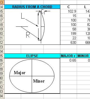

Why not scale them to the actual size you need them to print out at then copy and paste into the correctly sized merged cells. Its how have done it in the past. Hope this helps.
