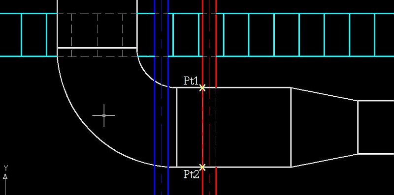

Please help me to fasten my work,:) my superior want me to do with multi-services layout (MEP combined services) by overlay the Individual layouts (Xref files) but he want to be specify the crossing services/lines drawing what will be the higher and lower services by creating a hidden line on the crossing lines, kindly see image so that it will be clear to you,
The duct and Pipe line are on crossing i want my pipe to be on lower than the Duct works, I'll trim/break then replace the trim line to hidden line,
it must be 2 line to be replace on the trimmed line, 1 is hidden and the other one is continious lines by different layers so that if they need the pipes line drawings only i will off the hidden and change to continious line again,:lol:
Is it possible to have an Lsp that automatically break the line and replace with 2 line (continious and hidden with different layers) then the continious line will automatically off so that only the hidden line will be represent, If you have Lsp like i needed please help me,:)
thanks to all,
Here you go

Of course i waited all day to write that code to see if anyone else was going to but... Lee a few things about your code.

i dont get why you wrote this in... break automatically does this.
Also he asked for 2 lines on 2 different layers 1 hidden 1 continuous.
I hope you dont think im assaulting you. Personally i learn alot from the codes you write. I just thought u could use some critisizm. 8)
I haven't got the AutoCAD experience to know that break automatically uses the getClosestPointto, so I just made sure they were points on the line anyway :D
As for the layers and other lines - tbh, I didn't completely read the request too carefully, I just looked at the pic :oops:
Ok, so with the linetype mistake changed...
(I still want to keep the getClosestPointto in there, just for safety :) )

Thanks Lee & Commandobill
Both of your Lisp are helpful, and sorry for the late response due to busy on schedule works :lol:
