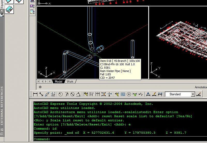

Elevate the pipework in accordance with your fall (you do the math). Then just ID each end of the pipe and take the level from your Z axis. I use a reference block to denote level from datum and level from structural slab. You can also do it from finished ceiling level or finished floor level.
I know its CADDuct but the same process should still apply, and its sinpler than working it all out everytime. Hope this helps dude :?
