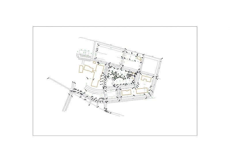

Exporting x y coordinates out of autocad map 2007 for surveying
I am in search of a lisp which puts a point with figure in a drawing when you snap a point .
It also needs to export the coordinates with the point number to a text file are a trimble m5 rec file.
It also needs to number automatic up, i need it for land surveying.
Can someone help me? meester.bert@live.nl

It dindt do any thing in autocad map :cry:
Check the end of this thread, may be what you are after :)
http://www.cadtutor.net/forum/showthread.php?t=19666
its a nice lisp but i need to snap on a point in a line or symbol.
And has to place a number with 1 or 100 and must number automatic.
and makes a coordinate list with the point numer.
I'm sorry, when you say snap - do you just mean that you are clicking the points where you need them, and you want these numbered and recorded?
I click on the opbject or symbol, yes the numbers need to come in a record with the pointnumber, northing and easting and the height.(pointnumber,x,y,z)
Surely this version of my LISP does just that:
A very nice lisp, Lee Mac. I like this version better than the previous, but could I be bold and point out a couple of areas that could be polished.
The point number, although it is meant to be an integer, somehow turns itself into a decimal number.
When in a UCS, the latest version writes the correct UCS coordinate to file, but places the point number text at WCS coordinates. The previous version wrote WCS coordinates to file, but placed the point numbers at UCS coordinates.
Otherwise I am keeping this one very handy :D
Thanks :) , I'm always open to suggestions :D
Sorry, I didn't include the the decimal and 0 dp arguments in the rtos function - my mistake.
I wanted to keep num as a real, and display it with no dp, due to the 32767 integer limit.
I must admit, I hate the UCS and haven't included anything to cope with this in this version, but I shall incorporate your ideas :)
Give this a shot, it should incorporate the UCS... but I am not too good with UCS conversion, so shout if it doesn't work :P
