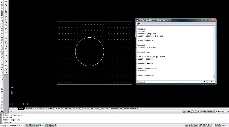

After you have done your selection with WPS command press enter.
Run ERASE command and when asked "Select objects" type P (for previous)
// Tobias

Hello!
We try one more time.
command: wps
Pick a circle or polyline: pick your circle
Select objects: ENTER
command: ERASE
select objects: P
15 found
select objects: ENTER
It works fine on my version of AutoCad
//Tobias
