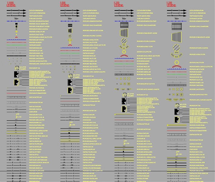

i have a legend creater written that simply inserts blocks that describe linetypes and symbols throughout a drawing.
Its old and kinda messy because it was one of the first lisp/dcl routines i wrote.
But it doesn't check what blocks are contained within a drawing - it only works by manual ticking of the check boxes.
You could create something more advanced if you want but its up to you.
My one at the moment just inserts differnt blocks that were set up for different scales
ive attached a pic of the result
also a pic of the form.
i'll give you the code if you want for it all and you can edit it from there.
Atleast its a start you know.

here is the dcl i'll post the lisp next

you will just have to make the blocks your self.
also i must say that i had a little help here and there from people on this forum when writing this.
But if you need any help let me know - i should be able to help you.
Cheers guys
Ps. The lisp file was too large so i split it into 2 files - just paste the contents of LEGEND2.lsp into LEGEND1.lsp
LEGEND.LSP
LEGEND2.LSP
How can I create dcl file?
I paste the code in txt then renamed to legend.dcl and but the lisp (after collecting the 2 parts) put there is an error message, The LEGEND.DCL file could not be loaded.
thats correct so far - but you need to have the legend.dcl file located within one of your acad search paths - then it will work.
Cheers - let me know how you go
I added a new search path and worked good
Thanx Russel

Hi Lee, this appears to be what I am looking for. Does this have the code for the dcl as well in it?
Yes, you only need to download the LISP file.
