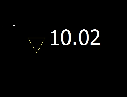

ok - i run that & the block now goes into the layer i want, but my text isn't appearing at all. i get this msg:
Select Point: Error: bad argument type: stringp nil
Haha I cannot believe we are having this much trouble with such a simple LISP :P:P:P
Its seems to run fine for me :)
well i get the same error message each time..... i'm in a brand new drawing, with all the blocks/layers that i need etc. ????? any idea what exactly that error message might refer to?
Here's what I have - it's same as yours except for the highlighted changes:

When I run your unchanged LISP it works as expected, but as far as I can see I've only changed little things, so I don't understand why it's having problems....
EDIT: ok, i think i've sorted it.... i had removed the suff variable on this LISP, but by leaving it in with the suff ="" (ie, no suff) it's working as i want it to!! :)
Its because the suff is missing:

thanks lee - i think that is all working now, at long last!!! thanks for all your help.....
