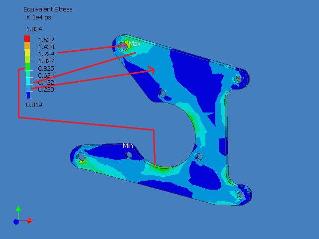

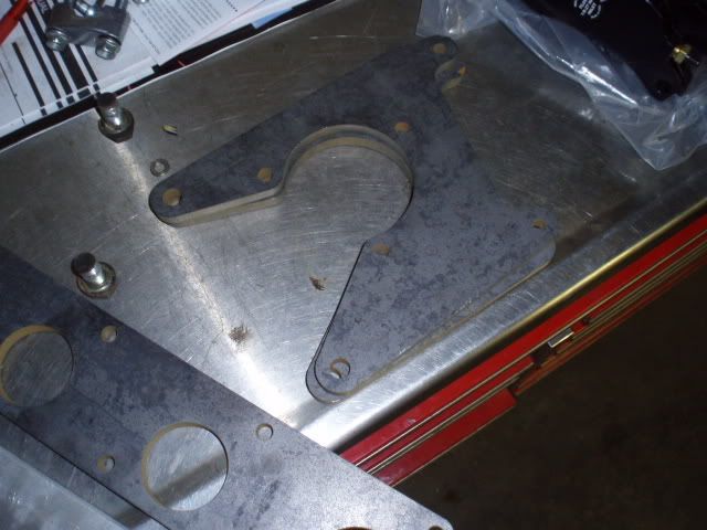

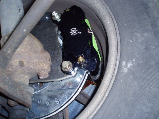

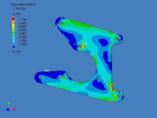

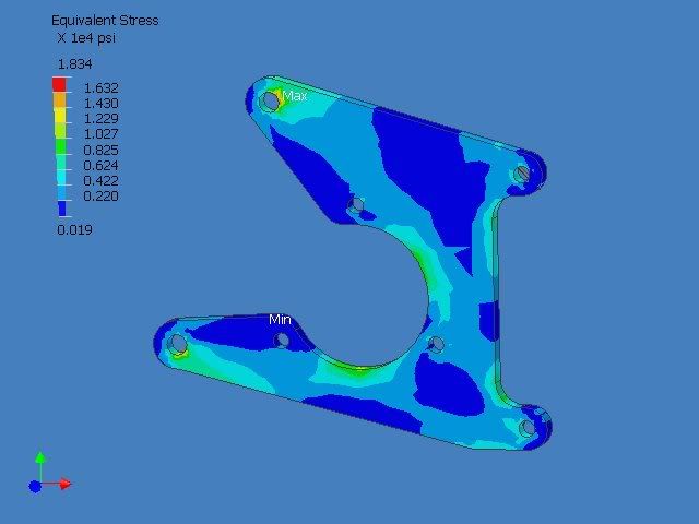

Here are a few screen shots of a big brake upgrade i designed and i used inventor to help narrow down how i wanted to restrain the plate and also material and thickness.
that was 3/8" steel only using the small hole where MAX is and the original caliper bracket holes on the left to hold the plate
same material leaving out the small hole as a bolt location.
You can see that changing the constraints makes a huge difference in stress distribution of the model. Understanding why this is so and what the effects are is cruicial. Not only for the part you are designing but the hardware you use, what its connected to etc. For instance in this case, the more rigid the plate was, the higher the stress concentration at fillets was. The more the plate was allowed to flex(max deformation) the lower the stress concentration was but in this case designing the bracket to handle the stresses rather than allow deflection was key.
With the help of the software my final model ended up being 3/8 steel plate and i used 4 locating holes.

Thanks for taking the time with such a detailed reply!! I do have a reasonable understanding of the physical loads and constraints on a part. But I think the part i am really struggling with, is the colored graph up the side of the results. For instance on your second example the figure at the bottom of the graph is 0.019 and at the top is 1.834. Now if you had to explain to someone what these mean(simply)?? How would you do it?? Also i have noticed that yor results are in psi!! mine are in MPa!! is there some way i can change this??
Sure thing. Once you have run the simulation you will have several result drawings to choose from. Both of the ones I had listed are equivalent stress. The color bar relates to the drawing. You can see Min and Max listed, those correlate to the min(.019) and max(1.834) values(both x 1e4psi or 18340psi). The colors on the bar give the values of each color region on the part. In the picture attached i drew some lines to the part. The distribution is based on the mesh created during analysis. The finer the mesh, the more accurate the distribution will be.
As for the units. Your drawing is probably metric so your units will be as such(MPa = 1 N/m^2). My drawing was in inches so my units were PSI(lbs/inch^2)
