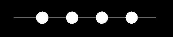

arman88 Posted February 17, 2008 Posted February 17, 2008 I'm trying to create a linetpye .The line needs to be continuous with a solid(not hollow) circles at distances.This would be the same as FENCELINE1: *FENCELINE1,Fenceline circle ----0-----0----0-----0----0-----0-- A,.25,-.1,[CIRC1,ltypeshp.shx,x=-.1,s=.1 ],-.1,1 but with filled-in circles.for example circles should be hatched or colored. An image of desired linetype is attached. Any help would be great.Thanks in advance. Quote
lpseifert Posted February 17, 2008 Posted February 17, 2008 Shapes can't have a solid fill/hatch. You can simulate the fill with closely spaced lines. Or use text instead of a shape; e.g. use the font file Arial with the character \U+25CF Quote
arman88 Posted February 19, 2008 Author Posted February 19, 2008 Thanks a lot for your concern I could do this by drawing several circles with same center near each other, which resemble a filled circle as you said.Then I made a shape file of these using the menu Express>Tools>Make Shape , which gives *.shp and *.shx file.I called this file in a *.lin file and it worked I don't know enough to perform what you said about using fonts, cause I am not that familiar and I've not worked with fonts. Anyway it solved :D8) Quote

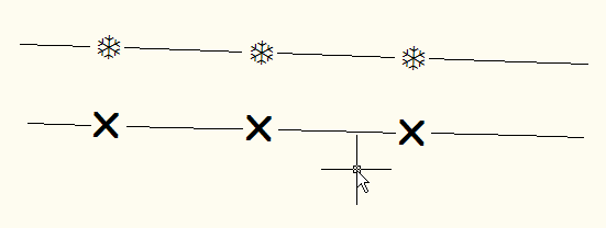

rkmcswain Posted October 8, 2009 Posted October 8, 2009 You can make all sorts of "text-based" linetypes with the various shapes that are in wingdings.ttf, webdings.ttf, etc. Here are a couple... Quote
