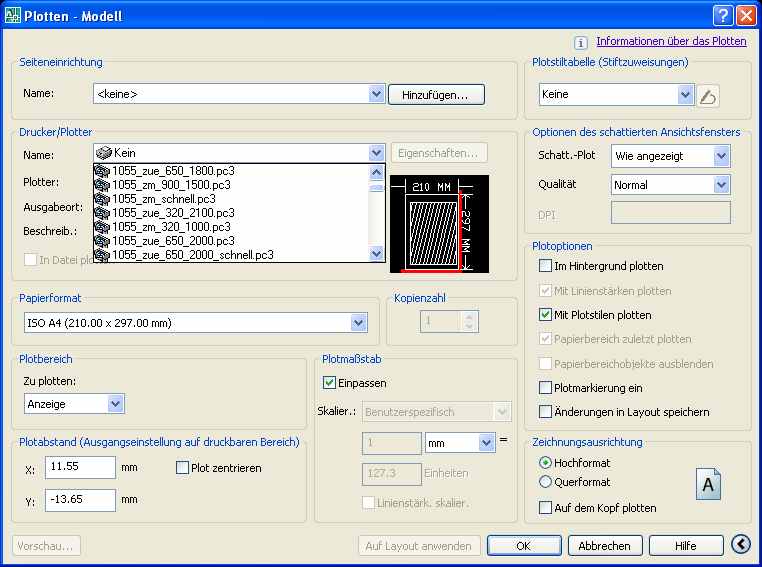

feargt Posted May 13, 2009 Share Posted May 13, 2009 Hi, I have not had any luck searching for an answer to this. See attached image for clarification of what I'm refering to. The screenschot is from a german version of autocad. We have a directory on our Network for all our pc3 files. This works as it should, everyone has access to the the same files and if someone creates a new pc3 file it saves as it should in this directory. My issue is, when I go to select a pc3 file from the pull down list, there does not seem to be any order whatsoever in the display list. Most of the pc3 files are called "1055_###_####" where ### represents the user defined sheet size. So in my pull down list I want to be able to scroll down through the list with the file names in order. At the moment they just seem all jumbled up with no specific order. Does anyone have any ideas on this matter? Quote Link to comment Share on other sites More sharing options...

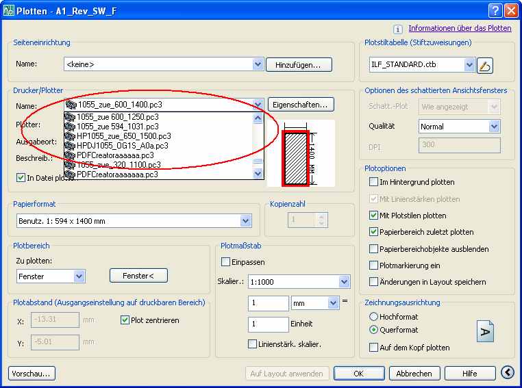

feargt Posted May 13, 2009 Author Share Posted May 13, 2009 It would be great if they were listed alphabetically but unfortunately they are not. In the image attached you can see that the second last pc3 file should be first in the list if thes were in alphabetical order Below is another example, where it just does not seem to follow any logical order. Or maybe it does but I just can't figure the logic out Quote Link to comment Share on other sites More sharing options...

feargt Posted May 13, 2009 Author Share Posted May 13, 2009 think I have solved the issue. The existing Network directory has for some reason, sub directories for each version of autocad since 2006. Each sub directory also has pc3 files. I created a new folder with the pc3 files that we need with no sub direcories and now it is as I want to have it. All neat in Alphabetical and numerical order! Quote Link to comment Share on other sites More sharing options...
