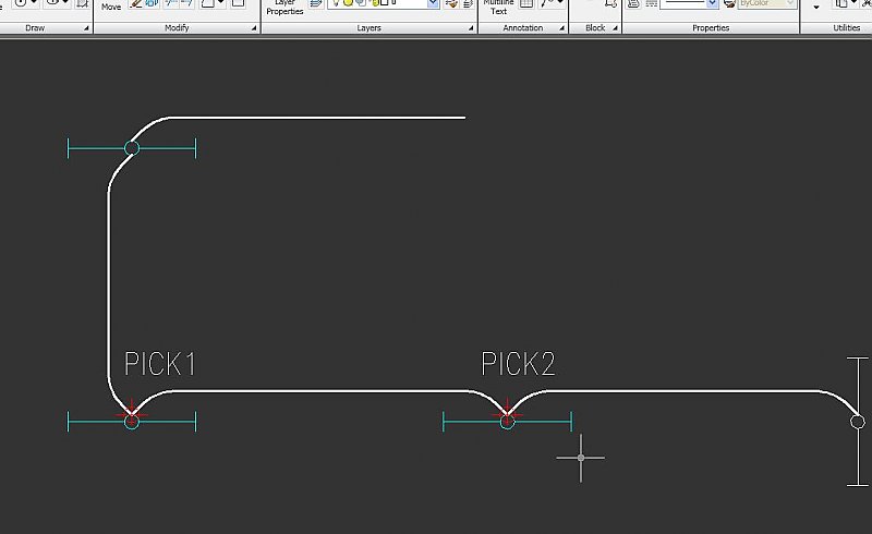

Good day to all :), is there any of there having a Lsp route on electrical wiring that will pick first fixture then the second fixture will automatically create a standard wiring pline as shown to the image.
The first pick will be line angle 45 degrees and then it will be bend horizontal or vertical line about 100mm far to the lighing fixture and in the next lighting fixture will bend 45 degrees again that will be the second pick for the next lighting fixture and then it will fillet by 150mm dia on each bend.:roll: this will be continious to the other lighting fixtures

Here is a quicky :)

Perfect!!! :lol: this is all i needed. Thanks CAB :)

the wiring Lsp is greate CAB,:) but i have some problem regarding when i use it on a rotated UCS plan the layout will not appear on the lighting fixture, it will will go away according to 0.0 UCS.:unsure: can you fix it on this causes. Thanks again:lol:
NICE! i changed it to have straight 45 edges and it work flawlessley :D
How did you change it? :o
Try this for UCS:

can you make the circuit line like image i uploaded , 45 degree line and the corner is filleted. and it's that possible that when we call a cmd and it ask for enter the fillet radius and the distance between fixture and circuit line
pls do a needfull.

There is at least 4 different style of answer in the old image. I have somewhere pick 1. Pick 1 has a left and right option. Start is another.
You need to post a true dwg of what you want.
