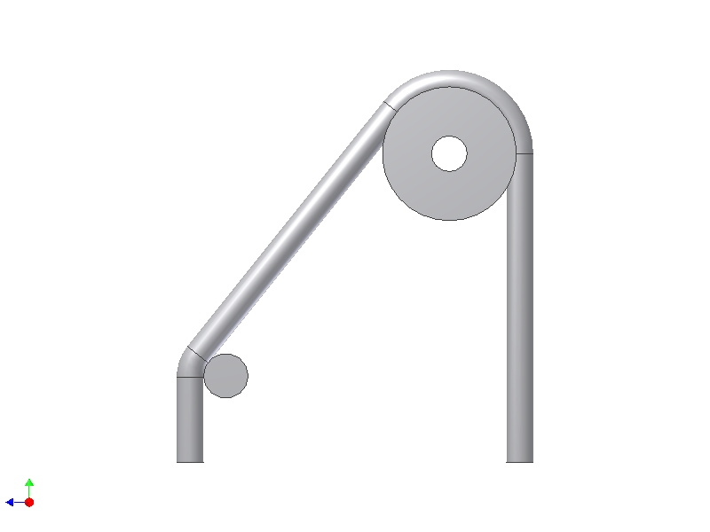

Deadwood Posted May 12, 2009 Posted May 12, 2009 I've looked and nobody seems to know how to do this. I want to create a flexible cable...one that can be wrapped around whatever I want like a pulley or just a round rod then apply a pulling force to it to lift or actuate something. I'm protective of showing my designs...so here's a sample we can work on that approximates the purpose of a flexible cable....the right side of the cable will be the side of the pulling force. Don't read too much into this pic...it's just for demonstration purposes. Quote

shift1313 Posted May 12, 2009 Posted May 12, 2009 After I saw your post(and after Devented posted his question) i played around with this a little more. In relation to your question deadwood, the only power transmission setup I was able to create was either a belt or chain(endless). I was using inventor 2010 and you are able to create flexible parts which alter based on other components in an assembly but I do not think it would work in the manner you intend. Im really interested in figuring this out but unfortunately I just have never done that before. Does your rope setup need to be a fixed length or can it be an endless closed section? Devented, i was looking through some of the "help" that IV2010 has, and one of the flexible hose helps is an excavation arm with hydraulic lines on it very similar to what you were trying to create. I was playing some last night and this morning but unfortunately I dont think i will have any time to mess with this for another week or two since I will be on vacation. Quote
Deadwood Posted May 12, 2009 Author Posted May 12, 2009 My setup requires a fixed length open end cable. I did think about and open end chain...I know I can drive an insert constraint at the links but I'm not sure if I can apply a sliding joint to the whole chain so it will move along the pulley/pivots. Others on other sites have asked this question and the thread just got dropped....can't Inventor do this?....I'm sure someone has designed a cable with a force applied to it to move a mechanism...just designing a bike with a gear shifter would accomplish this. Devented.....I think I found a solution to your problem....I'm pissed cause I lost what I originally typed cause of the post limit before posting links...ahhhh! Anyway, here's the long way....go to Autodesk.com discussion groups under Inventor...type "Flexible cable" in the search box to the right....scroll down to "Fixing the length of a conformable cable or hydraulic hose"....in there, scroll down to user dan_inv09...he provides a file named arm.zip....open up arm_assembly1.iam and look for the part named arm2...you'll have to extract or save to Inventor...under it there is an angle constraint named Drive this angle...drive this constraint and you'll see how the cable/hose keeps it's length and flexes as the arm bends in...if this will work for you, you'll have to figure out how to mimic it...I know I'm not at this level yet, lol....hope you understood all that. Quote

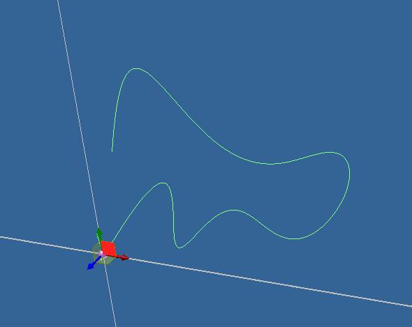

Devented Posted May 13, 2009 Posted May 13, 2009 So basically.. what the gist of these posts are pointing at, is that to make a cable/string/wire act like a cable/string/wire.. you cant use the cable/wire harness assemblies, you have to use a 3d spline? That seems kind of pointless that they wouldnt beef up the adaptablility of the wire/cable harnesses, as im assuming they were created to ease in the creation (and documentation) of wires and cables. I've known all along that using a 3d spline would probally work for what I needed it to do, however, actually drawing the damn thing to get a realistic curve of a hydraulic hose has been, well, frustrating to say the least. I wanted to use the wire harness for exactly what it was designed for.. ease of use! But I guess if you having any moving parts with wires/cables/strings/hoses attatched to it, you SOL... Quote
Deadwood Posted May 13, 2009 Author Posted May 13, 2009 3d spline is what I'm trying to learn...at least that's the direction I'm going...ya, drawing one is hard....and ya, I've tried the cable and harness feature but it doesn't move with the mechanism, never mind simulating with it. From what I understand, to create 3d spline, you need to create work planes, work points, or work axis to attach the spline...the more of these points you use the more constrained/restricted it becomes...less slack...for Devented, ya gotta seriously check out the link I was talking about previously...I'm sure that's one way of doing what you want...drawing it is another, lol...I'll work on 3d spline and show what I get done...might not be till tomorrow, I'll be bald by then...hehe. Quote
shift1313 Posted May 13, 2009 Posted May 13, 2009 when you are in a 3d sketch and you are drawing a spline you can click on the UCS icon or the planes(they will turn red). Quote
Deadwood Posted May 13, 2009 Author Posted May 13, 2009 This is what someone...I'm guessing someone with Autodesk....said on a thread I started there... "It is logged as a wishlist item Wish: NG: Customer wants a rope or wire / cable type functionality (belt joint is not sufficient)> We appreciate you bringing this to our attention. Best regards, -Hugh I'm now thinking Inventor can't do this... Quote
