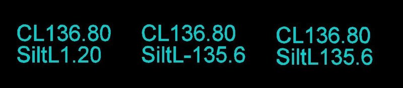

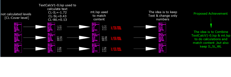

Hi all
Could someone help me to tweak this great mt.lisp , please.
I am looking to add additional code which could keep prefixes when match number content.
For example I have any text and number IL1.50 . I would like to match only number content 95.40 to get IL95.40
Many thanks for help!

Please upload yoursample.dwg with before and after

Thank you mhupp for your good idea. Text should  not be set specifically to CL,IL,WL etc... it could be anything, somehow text needs to be ignored and matched only numbers.
I am new to lisp editing, but trying to learn.

instead placing result anywhere, I would need to replace existing text  for example  SL1.10 replace with a  ''place result'' content?
Is there  a way to adjust this script so its not eliminating specific prefixes when matching content? for exampe: IL1.10  SL1.10  etc..
Currently its replacing and leaving 1.10
