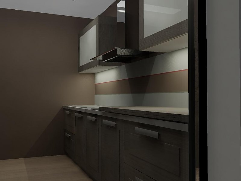

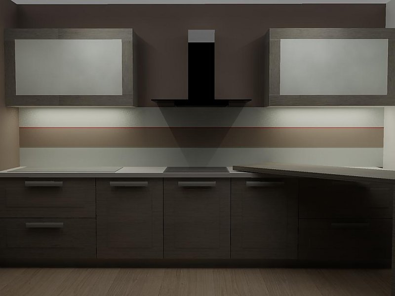

papagyi Posted May 11, 2009 Posted May 11, 2009 ok, here's what i get using photometric light. Eerything became kinda blury. What do you suggest doing now. Woo..woo...this topic shouldn't much posts! Ok..may i participate? Pls check this link and download my complete dwg file and play with it! Before you play,pls much read how other ask & answer !... http://www.cadtutor.net/forum/showthread.php?t=32178&page=2 Do you turn on GI&FG when you render with photometric light? Then you want to copy light one file from another,you will do block for light! Quote

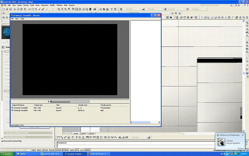

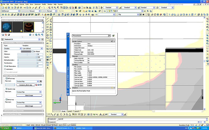

Dorian Posted May 12, 2009 Author Posted May 12, 2009 Read this thread: http://www.cadtutor.net/forum/showthread.php?t=35688 See if that helps you any. Ok, now i have a problem with rendering, with that setting here are print screens I tried papagyi's drawing and i get the same problem. Quote
Lazarus Posted May 12, 2009 Posted May 12, 2009 The Screen shots tell nothing as far as i can see.The first one shows that Final Gather is in progress,and the second one shows your render settings.What exactly is the problem? Quote
papagyi Posted May 13, 2009 Posted May 13, 2009 Pls check your 3d config setting!Coz my dwg is already fined with me and other!..So your graphic setting need to check!...Did you change something my dwg fri? Quote
Dorian Posted May 13, 2009 Author Posted May 13, 2009 sorry, my mistake, when i was rendering, the final gather was the blackness, than after the final gather was over the render worked , i tried your drawing and it was good. Now I'm starting to practice the photometric lights. Quote

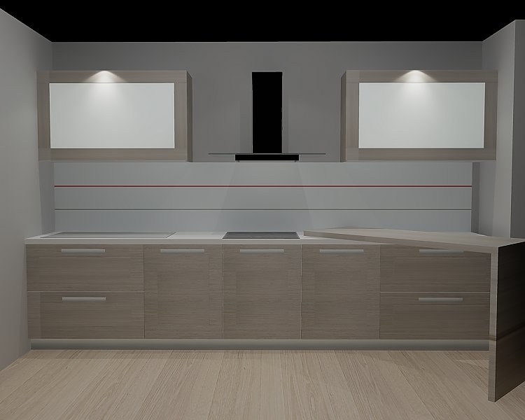

Dorian Posted May 14, 2009 Author Posted May 14, 2009 ok papagi i used your settings from the drawing for the rendering and your's is very realistic and here's mine. What would you suggest on doing next. Quote
papagyi Posted May 15, 2009 Posted May 15, 2009 Why your ceiling is black? If you want to use photometric lights to get realistic result,you must do like as actual lighting style and material .If you can upload your dwg,i will do for you and you can study quickly for realistic render (lights,materials,rendering setting..etc..). Quote

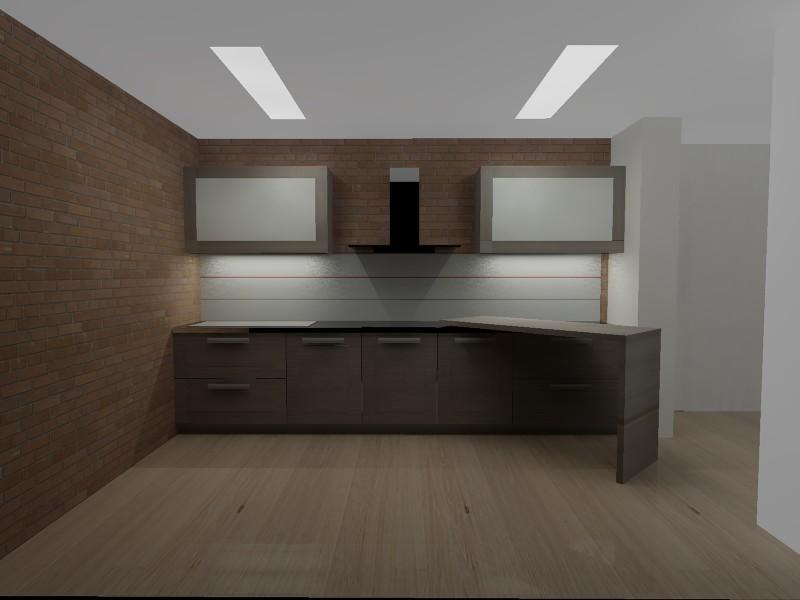

Dorian Posted May 16, 2009 Author Posted May 16, 2009 OK, I played a little bit with the settings, i put the sun ON, and changed some materials for higher quality textures put some bump map on them and i think the result is good, please comment. Quote
