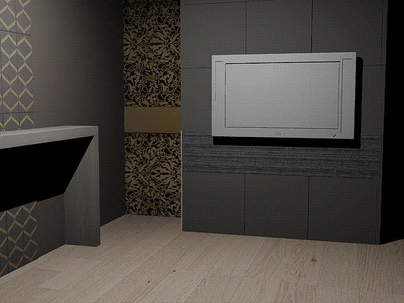

Dorian Posted May 11, 2009 Author Posted May 11, 2009 ok, here's what i get using photometric light. Eerything became kinda blury. What do you suggest doing now. Quote
