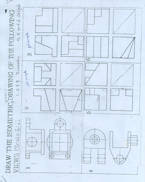

Zako Posted December 28, 2011 Posted December 28, 2011 I faced difficult problem of converting orthographic views into isometric views, Dear friend i need your urgent assistance since I have given the questions as home take exam. if you give me your email I may attach the problems and looking forward to your better help. sincerely Yours Zekeria Yusuf Email: zakoyusuf@yahoo.com Quote
ReMark Posted December 28, 2011 Posted December 28, 2011 Zako: You somehow managed to pull up a thread that dates back three years. If you need help with drawing a 2D isometric then post your questions and if possible an image of the object you are drawing. And it is never a good idea to post one's email address in a public forum. Quote
Zako Posted December 29, 2011 Posted December 29, 2011 As i have earnestly requested you. I don't have any experience in converting orthographic views into isometric or oblique drawings. I appreciate your cooperation in doing this assignment. Would you please convert them and send back to me. Kind Regards, Zekeria Y. Habib Quote
ReMark Posted December 29, 2011 Posted December 29, 2011 Zako: You should have started a new thread rather than continuing to post to an old one. You might benefit from taking a look at a book about technical drafting. Developing views whether on a drafting board or on a computer using a CAD program will require pretty much the same approach. Nice image but without any readable dimensions anything one of us could create would end up only being an approximation. Have you ever drawn an isometric view of an object by hand? Do you know how to set up your drawing environment (in CAD) for creating an isometric drawing? I'm assuming you want to do this all in 2D right? Quote
Zako Posted December 29, 2011 Posted December 29, 2011 Dear friends I presume that you might have better experience than me. This is why i am looking for your help. Would you please insert into soft ware and work it even its approximate drawing so that i may relieve. In the future we will be friends and so much to share. cordially ReMark said: Zako: You should have started a new thread rather than continuing to post to an old one. You might benefit from taking a look at a book about technical drafting. Developing views whether on a drafting board or on a computer using a CAD program will require pretty much the same approach. Nice image but without any readable dimensions anything one of us could create would end up only being an approximation. Have you ever drawn an isometric view of an object by hand? Do you know how to set up your drawing environment (in CAD) for creating an isometric drawing? I'm assuming you want to do this all in 2D right? Quote
ReMark Posted December 29, 2011 Posted December 29, 2011 You presume a lot. We'll see what we can do. In the mean time, I would respectfully ask that you respond to the questions I put to you. Quote
JD Mather Posted December 29, 2011 Posted December 29, 2011 I would model as 3D and then explain to the teacher that the assignment is a holdover from well into the last century where we didn't have 3D CAD software or did everything on a drafting board. A couple of years before that we did everything with charcoal on a cave wall. If your teacher expects you to use these ancient methods - did the teacher show you how to set isometric grid use F5 for toggling isoplanes show you how to create ellipse isocircles If I converted them for you and sent them back to you - how will that help you learn to do the ancient ways? Quote
ReMark Posted December 29, 2011 Posted December 29, 2011 Zako: Is this assignment for school? Yeah, not too bad for having no dimensions to work off of. The image isn't going to do him much good as he doesn't have a DWG file to go with it. Quote
JD Mather Posted December 29, 2011 Posted December 29, 2011 ReMark said: Yeah, not too bad for having no dimensions to work off of. Looks like the typical school problem where it is actually on a grid (hard to see in low res image) and the instructor assigns a magnitude to the grid spacing. In any case, the instructor should provide instruction on how to do similar problems before giving out an assignment. Quote I appreciate your cooperation in doing this assignment. If only the internet had existed back when I was in school. How much are you willing to pay for me to cooperate in doing this assignment for you? Quote
ReMark Posted December 29, 2011 Posted December 29, 2011 Anybody else want to take a crack at one? Just post image files no DWG files. Don't want to make it too easy. If there was a grid in there I sure as heck couldn't see it. Of course I'm blind in one eye so I'd only see half the grid anyway! LOL Quote
JD Mather Posted December 29, 2011 Posted December 29, 2011 Zako, If you really want to learn how to do this (rather than pay someone to do it for you), pick one of those parts - just one for now - and attach a better image of just that one part and indicate grid spacing. Someone here will walk you through the process line-by-line. Along the way you will be asked to attach dwg file of what you have completed at each step to make sure you are following the instructions correctly. So simple! So easy! So logical! Quote

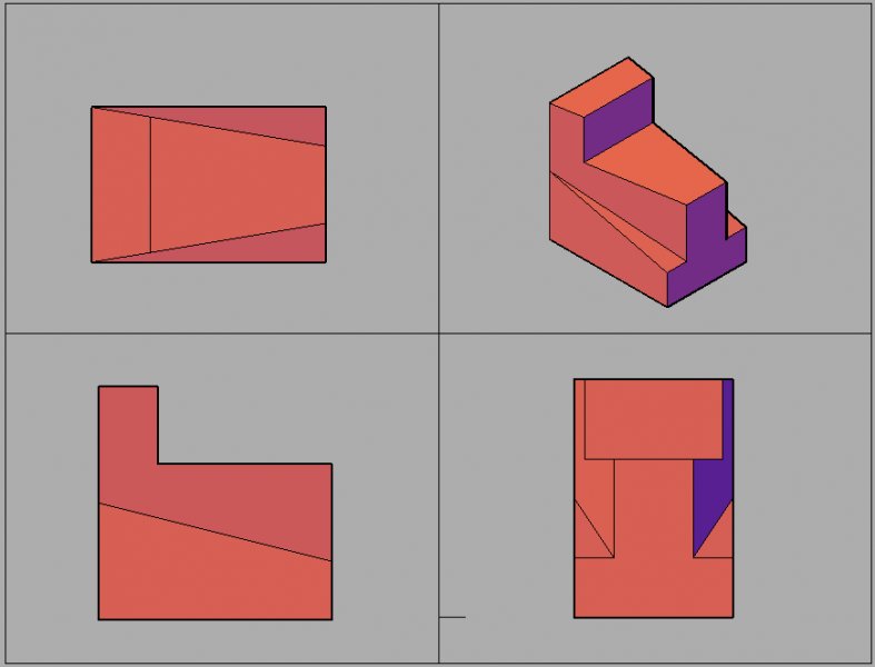

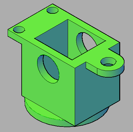

ReMark Posted December 29, 2011 Posted December 29, 2011 (edited) Corrected image. Thank you JDM for pointing out the flaw. Edited December 29, 2011 by ReMark revised 3d model Quote
JD Mather Posted December 29, 2011 Posted December 29, 2011 ReMark said: Another example to muse on. . It is not correct - where is the large cylindrical feature? Quote
