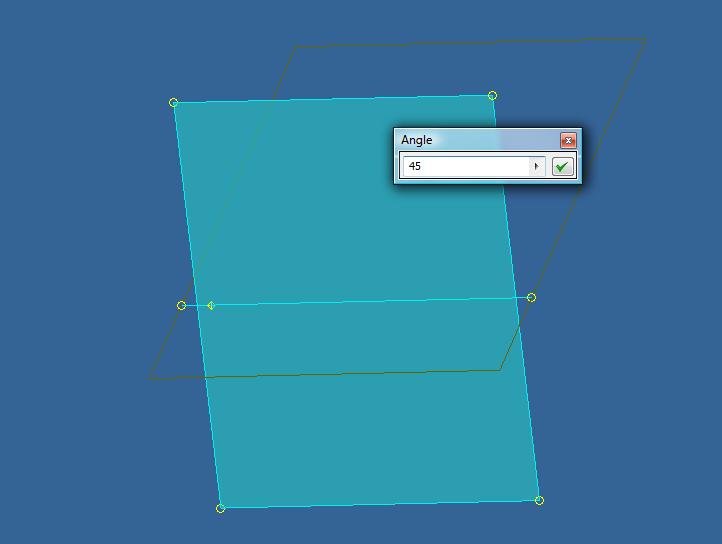

shift1313 Posted May 3, 2009 Posted May 3, 2009 well in an assembly your mates are what will decide part orientation(not how you draw it). If you draw a component and select the face of another part or one of their planes(or one of the assembly planes) it will create a constraint with that plane. If you do want to create a plane at an angle you just need a reference plane and a line(either a reference line, ie one of the x y or z axis). Your new plane will pivot around your reference line, and the angle will indicate its angle from the reference plane you selected. For instance if you turn on visibility of the Y axis and the YZ plane. Select Work Plane, or press ] , select your Y axis, then select your YZ plane(either in the model space or on your design tree). An angle prompt will appear and let you enter the angle for this plane. You do not need a work axis, the line can be a sketch line or edge of a part. Quote
