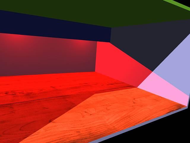

tzframpton Posted May 1, 2009 Posted May 1, 2009 Need a little help. I've tried different types of lights, shadows on/off, etc, but nothing helps. The posh hanging down is actually larger than the room's walls and ceiling, so there should be no bleed coming through the two lights but I'm still getting it. Anyone know off the top of their head what the issue could be? Thanks again. :wink: Quote
tzframpton Posted May 1, 2009 Author Posted May 1, 2009 the floor and walls are REGIONs. the Posh and ceiling are solids. Quote

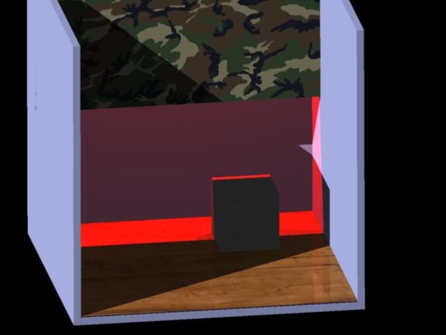

shift1313 Posted May 1, 2009 Posted May 1, 2009 i created a quick model using solids. I added some red point lights behind the fixture so you could see the bleed and didnt get any. Quote

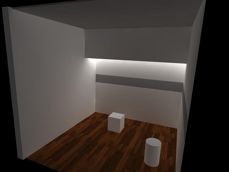

shift1313 Posted May 1, 2009 Posted May 1, 2009 sorry i got a bit sidetracked. i made the walls, light box and roof all different colors so there was some contrast and i sent the render to presentation and still no bleed through. all my object(except the wood floor) are 3d solids. you said some of yours were regions? forgot to add the pic Quote

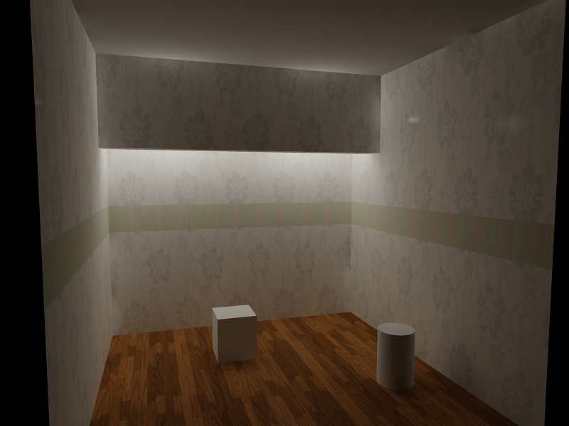

shift1313 Posted May 1, 2009 Posted May 1, 2009 well when i render your file i get the light bleed issue in 07. If i replace your region with a solid wall, the problem seems to go away. Quote
tzframpton Posted May 1, 2009 Author Posted May 1, 2009 gotcha. I still kept the ceiling as a region and that's where my mistake was. Thanks a lot again Matt, problem solved. Quote

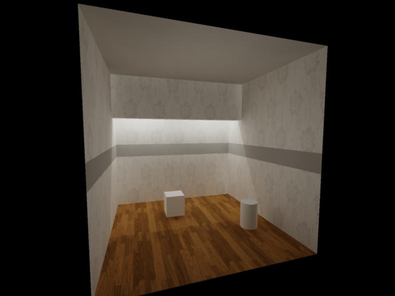

papagyi Posted May 1, 2009 Posted May 1, 2009 The image i showed for you that made only turn on your lights shadows. Here is mate!I tested with acad 2008! 3D Test.dwg Quote
tzframpton Posted May 1, 2009 Author Posted May 1, 2009 The image i showed for you that made only turn on your lights shadows.Here is mate!I tested with acad 2008! Hmm..... That does work, with simple shadows. Two problems: I hate "simple shadows" because they are the most unrealistic shadow mapping available IMO, and I don't want to case any shadows. So can I fix this without turning shadows on and using simple shadows in the advanced render settings? Quote
