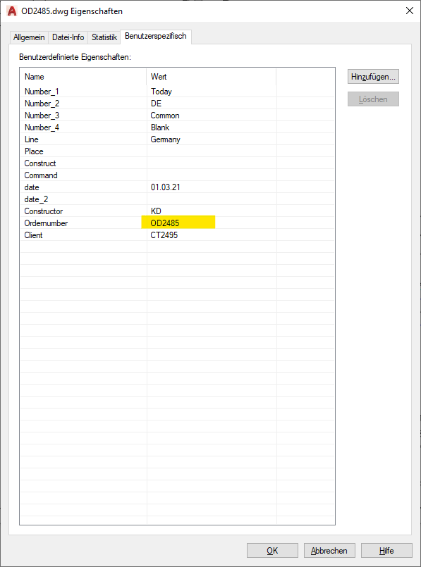

Hi all, is it possible to read attributes or properties from the _DWGPROPS and list them in a Lisp e.g. as variables?
I need the yellow marked attribute (OD2485), which always has a different number.
(defun c:dropsforatts ()
(setq (vla-get-ActiveDocument
(vlax-get-acad-object))
(vla-get-SummaryInfo doc)
(setq i 0)
(setq i 5)
I would then like to insert this variable into a file path in a Lisp.
