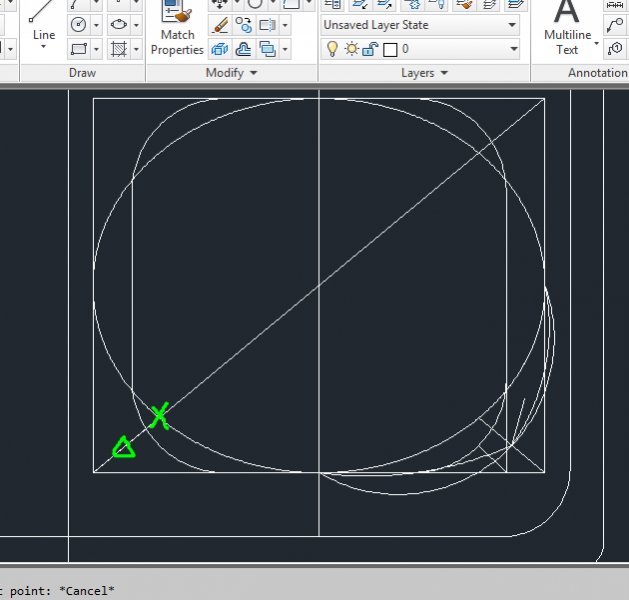

Ok I hope this is in the right section. Anyways, I'm trying to make a (for lack of a better term) squarish ellipse. I know that sounds odd and the situation is a little subtle so please bear with me. I've tried a few things but they don't work too well, i.e. plines and lofting a rectangle with an ellipse then cutting it two but they just get me arcs that meet at sharp points. The jpg below is meant to show what I'm trying to do. I want to take that one quarter of an ellipse at the intersection and stretch/pull it to the midpoint of the line between the corner of the rectangle and the arc. The ellipse is made out of 4 ellipse arcs. I want to stretch just the arc without moving the ends of it at the quadrants. How might I do this? Any help would be greatly appreciated.- 4 replies
