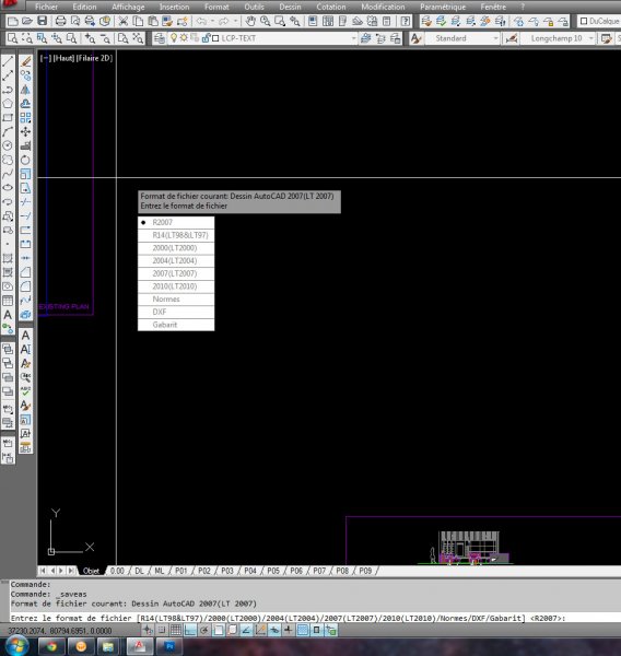

hello something's changed in my autocad 2012 setup and I'm being asked to provide full written addesses within the system for files I want to "save as" under a different name, or insert as raster images for example. the moment I click on "save as" an on screen request pops up, like the one you s...
