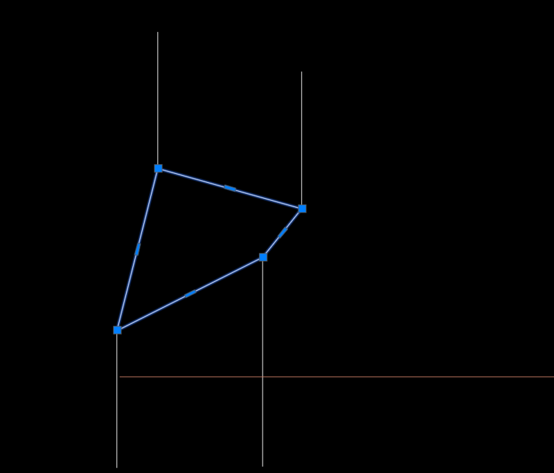

Ajmal posted a topic in AutoLISP, Visual LISP & DCL
Can someone help me to find the solution for some doubts. If someone will make one lisp for this, so I think I will get answer for few doubts I need to draw a pline inside this 4 line using line point like this My doubts 1 how to get “line point” with window selection (4 line all pints not in window only 4 line 4 point) (setq p1 (getpoint "\nSelect object...")) (setq p2 (getcorner p1)) (setq mp (polar p1 (angle p1 p2) (/ (distance p1 p2) 2))) (setq p1 (list (nth 0 p1) (nth 1 p1))) (setq p2 (list (nth 0 p2) (nth 1 p2))) (if (not (equal '(nil nil) (sssetfirst nil (ssget "_C" p1 p2 '((0 . "LINE")))))) (setq lines (ssget "_:L"))) (if (/= (sslength lines) 4) (alert "4 lines need to be selected") 2 how to segregate the entity (which one is first which one is last) 3 how to entmake pline -

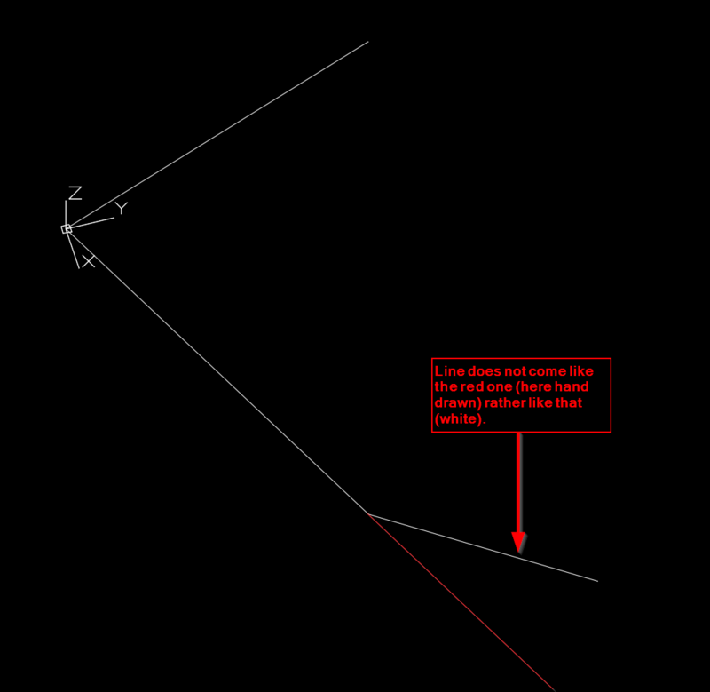

In continuation of this thread I would like to continue this interesting story about UCSs and transformed entities. So far I have understood ( I am thankful to the community here) that An OCS is an coordinate system that most of the Autocad entities use instead of any other CS An OCS share the same origin with the WCS, however its x,y,z may be other than the one of the WCS However, it seems that something still eludes me and I cannot fully grasp it. I made a very simple model with a line drawn in WCS from 0,0,0 to 1,2,3. I would like to insert the same model on this one, that is having this line sitting on the end point (1,2,3) of the other as an extension. That means the lines need to be collinear. Let's assume I mirror3d this line on the xy plane, so the extrusion vector now becomes 0.0 0.0 -1.0. Using the following snippet the line comes on the correct placement but the orientation is wrong. What am I missing? ; clicking the mirrored entity from 0,0,0 to 1,2,-3 (setq pt (cdr (assoc 11 (setq ent (entget (car (entsel))))))) (setq v (cdr (assoc 210 ent))) ; inserting the drawing (entmakex (list (cons 0 "INSERT") (cons 2 "Dwg") (cons 8 "0") (cons 10 (trans (trans pt 0 1) 1 v)) (cons 70 0) (cons 66 1) (cons 50 0) (cons 210 v) ) ) Any suggestions appreciated.

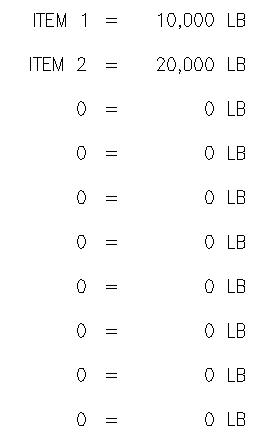

I am trying to write a routine that allows users to input items and weights in a dialog box, and outputs a formatted MText (among other things). I allow the user to input up to 10 items, but I only want the MText to use the values that are filled in. Here's what my dialog box looks like: And here's what my output looks like: Here's my code for the Mtext: (setq val (strcat "\\pxtr18,c20,r30;\t" eq1 "\t=\t" wt1 " LB \\P\t" eq2 "\t=\t" wt2 " LB \\P\t" eq3 "\t=\t" wt3 " LB \\P\t" eq4 "\t=\t" wt4 " LB \\P\t" eq5 "\t=\t" wt5 " LB \\P\t" eq6 "\t=\t" wt6 " LB \\P\t" eq7 "\t=\t" wt7 " LB \\P\t" eq8 "\t=\t" wt8 " LB \\P\t" eq9 "\t=\t" wt9 " LB \\P\t" eq10 "\t=\t" wt10 " LB" )) (entmake (list (cons 0 "MTEXT") (cons 100 "AcDbEntity") (cons 100 "AcDbMText") (cons 10 pt1) (cons 1 val) (cons 8 "NOTES") (cons 40 0.09375) (cons 7 "ROMANS") (cons 41 4))) Any suggestions how to make it ignore the "0" values? Thanks in advance!
