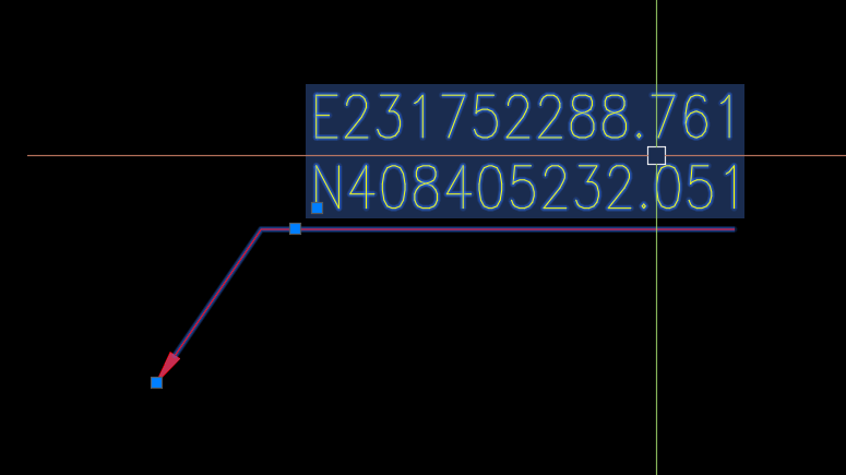

(defun c:bcr (/ Make_MText i ss ent) (defun *error* ( msg ) (foreach lay lck (vla-put-lock lay :vlax-true)) (if (= 'int (type cmd)) (setvar 'cmdecho cmd)) (LM:endundo (LM:acdoc)) (if (not (wcmatch (strcase msg t) "*break,*cancel*,*exit*")) (princ (strcat "\nError: " msg)) ) (princ) ) (defun Make_MText (pt str) (entmakex (list (cons 0 "MTEXT") (cons 100 "AcDbEntity") (cons 100 "AcDbMText") (cons 10 pt) (cons 1 str)))) (if (setq i -1 ss (LM:ssget "\nSelect block <exit>: " '(((0 . "INSERT"))))) (while (setq ent (ssname ss (setq i (1+ i)))) (Make_MText (cdr (assoc 10 (entget ent))) (apply (function strcat) (mapcar (function strcat) '("E " "\nN") (mapcar (function rtos) (cdr (assoc 10 (entget ent))))))))) (princ)) (defun LM:ssget ( msg arg / sel ) (princ msg) (setvar 'nomutt 1) (setq sel (vl-catch-all-apply 'ssget arg)) (setvar 'nomutt 0) (if (not (vl-catch-all-error-p sel)) sel) ) every time when i make leader i have to put "p2" i need fixed type leader. as shown this is text. but i need text with leader or ml leader how can i make ?????
