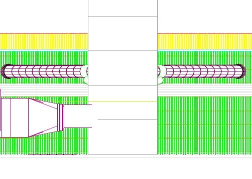

Lee Mac Posted April 12, 2009 Posted April 12, 2009 (edited) Hi Guys, Wasn't that busy, so I thought I'd put together a little Incremental Numbering Suite for you all to sample. I've come to realise that this kind of LISP seems to be quite a popular one in many trades, and this was my main inspiration for its creation. As with all my programs - your comments and/or criticism is welcome, as this only helps to improve the program itself. Thanks & Enjoy! Cheers Lee Incremental Numbering Suite Main Dialog Preview: Content Builder Preview: About Dialog Preview: A full description of the program and the latest version can be found here. Edited June 30, 2025 by Lee Mac Quote

Lee Mac Posted April 13, 2009 Author Posted April 13, 2009 This is a preliminary - I am thinking DCL may be a good call - but not sure... Let me know of your thoughts on this: Quote
