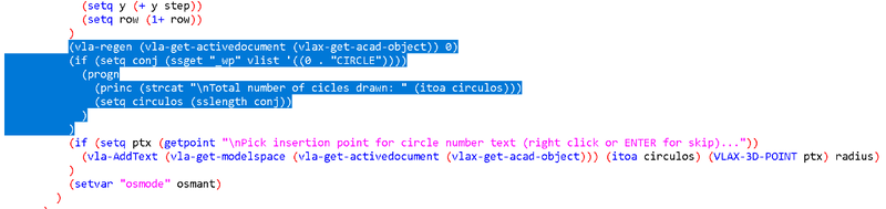

  5. It's easy To not complicate the code further, simply add the code highlighted in blue in the image, in the same position as shown

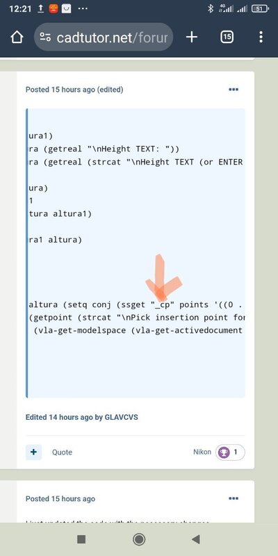

  7. I don't understand why you changed the selection mode. The mode should be '_cp', not '_wp' In the last code I attached it is as it should be. Don't touch it

  11. Wait I don't know what's going on I edited the code but the website hasn't updated it again I'll try again.
    1 point
  12. I just updated the code with the necessary changes. Please check if everything is working properly
