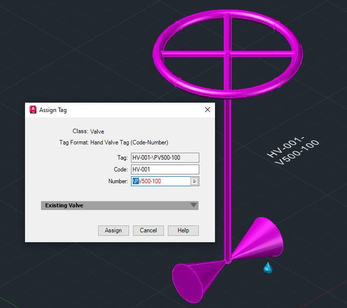

  1. @Rovinator Your code works, except you would have to either: 1) Parse the "tag" property to add in the return code before inserting the tag. 2) Add the return into the tag itself. Here is some code for option 1. I added in the function (pjk-StrParse), and added in some basic error handling. Tested minimally. NOTE: this only works properly if your tags always have the SAME format, i.e. the same number of "-" dashes, such as X-X-X-X (the X"s can be any length) (defun c:VTL ( / cnsap myEnt pt1 sc strlst valvetag vlaobj) (vl-load-com) ; get the Valve number from piping obj (setq CSNAP (getvar "osmode")) (setvar "osmode" 512) (if (and (setq SC (getreal "\Text Height: ")) (setq myEnt (car (entsel "\nSelect Valve: "))) (setq PT1 (getpoint "\Pick Label Location: ")) ) (progn (setq vlaobj (vlax-ename->vla-object myEnt)) (if (vlax-property-available-p vlaobj 'Tag) (progn (setq ValveTag (vlax-get-property vlaobj 'Tag) strlst (pjk-Strparse valvetag "-") valvetag (strcat (nth 0 strlst) "-" (nth 1 strlst) "-\\P" (nth 2 strlst) "-" (nth 3 strlst)) ) (setvar "ATTDIA" 0) (Command "-insert" "ValveNumberTag1" PT1 SC "" pause ValveTag "") ) (princ "\nTag Property not found for select object.") ) ) ) (setvar "osmode" CSNAP) (princ) ) ;|============================================================================== Function Name: (pjk-StrParse) Arguments: str = String; String to process del = String; Delimiter to separate the string Usage: (pjk-StrParse <string> <delimter>) Returns: List; A list of strings Description: Separates a string into a list of strings using a specified delimiter string; uses recursion. ================================================================================|; (defun pjk-StrParse (str del / pos) (if (and str del) (if (setq pos (vl-string-search del str)) (cons (substr str 1 pos) (pjk-StrParse (substr str (+ pos 1 (strlen del))) del)) (list str) ) ) ) ;; End Function (pjk-StrParse) Option 2 - NO CODE:

  2. Welcome aboard. Try adding (vl-load-com) at start of code. If that does not work can you post code here ?
