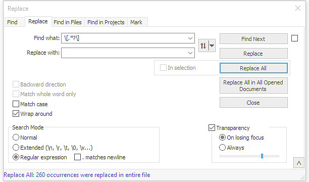

  6. To remove those pesky legacy color tags in forum code I use this regex in Notepad++ : \[.*?\] The "Find what" box should contain \[.*?\] The "Replace with" box should be kept empty. The "Wrap around" option should be selected The "Search Mode" should be set to "Regular Expression". Hitting the "Replace All" button will remove everything within Square Brackets including the brackets.
