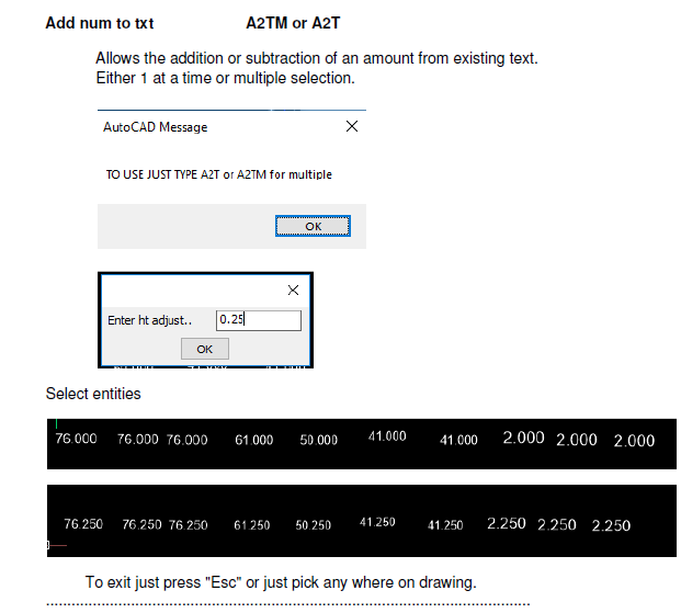

  2. I would look into doing help style answer, you can open a text file real easy using say notepad, (command "notepad" "d:\\acadtemp\\lsp.txt"), you can open a Word doc similar method, open a movie and more. Just add a defun like mylisphelp, add to a menu I have a word doc containing "how to" its like 29 pages of help. It has images and instructions.
