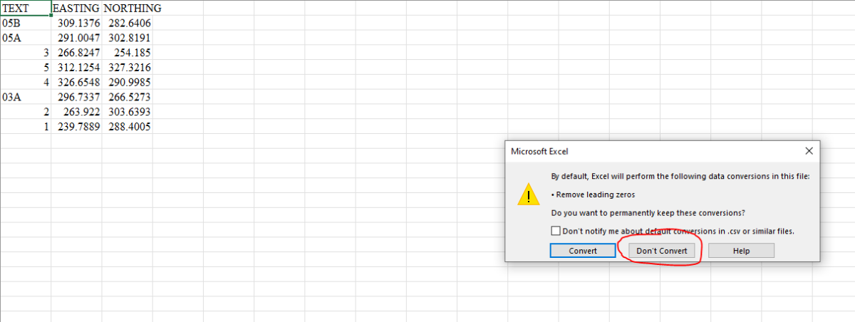

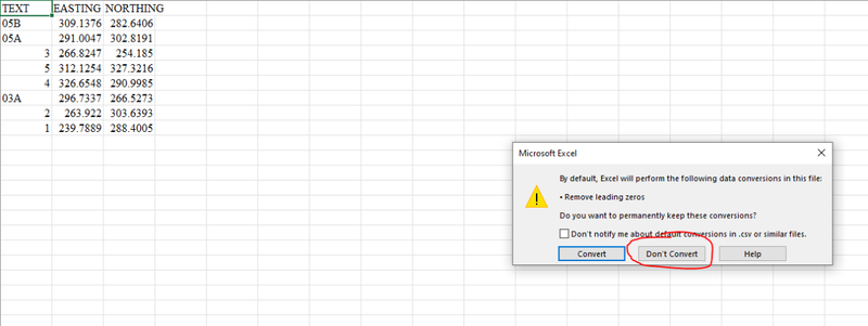

  4. Hi @Ish Try this: (defun c:EXMLD ( / save_location header op ss len i vals data pt pt_x pt_y ss2 data2 data3 val) (setq save_location (getfiled "Select a location for save" "" "csv" 1)) (setq header (strcat "TEXT" "," "EASTING" "," "NORTHING")) (setq op (open save_location "a")) (write-line header op) (setq ss (ssget "X" '((0 . "MULTILEADER")))) (setq len (sslength ss)) (setq i 0) (while (< i len) (setq vals nil) (setq data (entget (ssname ss i))) (setq pt (nth 56 data)) (setq pt_x (cadr pt)) (setq pt_y (caddr pt)) (command "._explode" (ssname ss i)) (setq ss2 (ssget "X" '((0 . "INSERT")))) (setq data2 (entget (ssname ss2 0))) (setq data3 (entget (entnext (cdr (assoc -1 data2))))) (setq val (cdr (assoc 1 data3))) (command "._undo" "1") (setq vals (strcat val "," (rtos pt_x 2 4) "," (rtos pt_y 2 4))) (write-line vals op) (setq i (1+ i)) ) (close op) (princ (strcat "\nThe data was saved in " "\"" (vl-filename-base save_location) "\"" ".")) (princ) ) To sort a list, after saving file, is much easier to do in excel using a "filter" above "Text" column. If this happen on picture 1, use the "Don't convert". Best regards.
