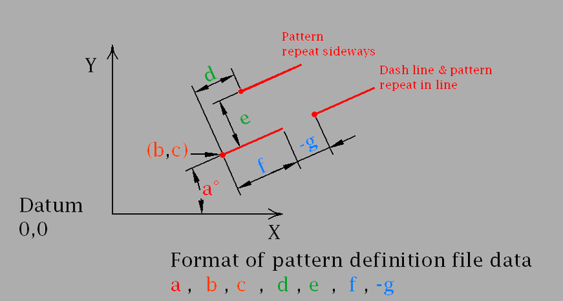

  5. If you had wanted the delta-y of the second two lines to be 1, then the delta-y of the 0 angle line would have to be (4 divided by the square root of 2) instead of 1.
    1 point
  6. The mathematics are (Square root of 2) divided by 4. It is the perpendicular distance between the 45 degree lines, based on the horizontal lines being 1 unit apart. Delta-y is always measured perpendicular to the line being defined. Perhaps my diagram of the pattern data may help. The delta-y is labelled "e"
    1 point
