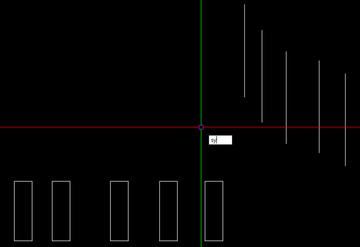

  1. This is taking the above a little further, but is not as finished as I might want. The user can alter the direction before or after selecting the entities rather than selecting the direction and then the entities. I reckon if you are using grread in something similar you are wanting quite a complex solution, most users are happy with 'select an option and enter' to continue. A bit of work to do another time so show the rubber bands for the stretches and to add in object snaps, but I am just adding this in here as an example - I might get more chance to look at this another day. (defun c:GRStretch ( / mod MyDist MyEnt MySS pt1 pt2 pt3 pt4 endloop acount) (setq endloop "No") (setq mod "X") (princ (strcat "Press \"X\" or \"Y\" [" mod "], select entities to stretch, or [ENTER] to exit: ")) (while (and (setq g (grread t 14 2)) (= endloop "No") ) (cond ((= (car g) 2) ;;Set mode - text entry (if (or (= 88 (cadr g))(= 120 (cadr g))) (setq mod "X")) ; x, X (if (or (= 89 (cadr g))(= 121 (cadr g))) (setq mod "Y")) ; y, Y (if (or (= 13 (cadr g))(= 32 (cadr g))) (setq endloop "Yes")) ; end loop marker ;;NUMBER ENTRY (if (and (< 48 (cadr g)) (< (cadr g) 57)) (progn (princ "\n")(princ (chr (cadr g))) (setq MyDist (atof (strcat (chr (cadr g)) (rtos (getreal)))))(princ "\n")(princ MyDist) ) ) ;;END NUMBER ENTRY (princ (strcat "\nPress \"X\" or \"Y\" [" mod "], select entities to stretch, or [ENTER] to exit: ")) ; change of mod ) ; end text entry cond ((= (car g) 3) ;;Set click (cond ; set / reset points ((= pt1 nil)(setq pt1 (cadr g))) ((= pt2 nil)(setq pt2 (cadr g))) ((= pt3 nil)(setq pt3 (cadr g))) ((= pt4 nil)(setq pt4 (cadr g))) ( T (setq pt1 nil)(setq pt2 nil)(setq pt3 nil)(setq pt4 nil)) ; reset points ) (if (setq MyEnt (car (nentselp pt1)) ) ; if single entity selected (progn (redraw MyEnt 3) (setq pt2 pt1) (princ (strcat "\nSingle Entity Selected.\nSpecify base point (or X, Y) [" mod "].")) ) ; end progn ) ; end if (if (and pt1 pt2 (not MyEnt)) (progn (if (< (car Pt1)(car Pt2)) ; L->R Selection (setq MySS (ssget "_W" Pt1 Pt2 )) ; Window selection (setq MySS (ssget "_C" Pt1 Pt2 )) ; crossing selection ) (redraw) (if MySS (progn (setq acount 0) (while (< acount (sslength MySS)) (redraw (ssname MySS acount) 3) (setq acount (+ acount 1)) ) ; end while MySS (princ (strcat "\nEntities Selected.\nSpecify base point (or X, Y) [" mod "].")) ) ; end progn (progn (setq pt1 nil)(setq pt2 nil)(setq pt3 nil)(setq pt4 nil) ) ) ; end if MySS ) ; end progn ) ; end if pt1, pt2, not MyEnt ) ; end click entry cond ((and pt1 (not pt2) (= (car g) 5) (not MyEnt) ) ; Draw selection rectangle (setq p3 (cadr g)) (setq p2 (list (car pt1) (cadr p3))) (setq p4 (list (car p3) (cadr pt1))) (redraw) (grvecs (list -256 pt1 p2 p2 p3 p3 p4 p4 pt1)) ) ) ; end conds ;;Single entity stretch ; (if (and pt2 MyEnt) (if (and pt3 MyEnt) (progn (princ "\nSpecify second point") (if (= mod "X") ; X or Y axis ; (command "_.stretch" MyEnt "" (mapcar '* '(1 0 0) pt2) (mapcar '* '(1 0 0) (setq pt3 (getpoint)))) ; (command "_.stretch" MyEnt "" (mapcar '* '(0 1 0) pt2) (mapcar '* '(0 1 0) (setq pt3 (getpoint)))) (command "_.stretch" MyEnt "" (mapcar '* '(1 0 0) pt3) (mapcar '* '(1 0 0) (setq pt4 (getpoint)))) (command "_.stretch" MyEnt "" (mapcar '* '(0 1 0) pt3) (mapcar '* '(0 1 0) (setq pt4 (getpoint)))) ) (redraw MyEnt 4) (setq pt1 nil)(setq pt2 nil)(setq pt3 nil)(setq pt4 nil) ; reset points (setq MyEnt nil)(setq MySS nil) ; reset entity selection (princ (strcat "Press \"X\" or \"Y\" [" mod "], select entities to stretch, or [ENTER] to exit: ")) ) ; end progn ) ; end if ;;Selection set stretch (if (and pt3 MySS) (progn (princ "\nSpecify second point") (if (= mod "X") ; X or Y axis (command "_.stretch" MySS "" (mapcar '* '(1 0 0) pt3) (mapcar '* '(1 0 0) (setq pt4 (getpoint)))) (command "_.stretch" MySS "" (mapcar '* '(0 1 0) pt3) (mapcar '* '(0 1 0) (setq pt4 (getpoint)))) ) (setq acount 0) ; remove highlights (while (< acount (sslength MySS)) (redraw (ssname MySS acount) 4) (setq acount (+ acount 1)) ) ; end while MySS (setq pt1 nil)(setq pt2 nil)(setq pt3 nil)(setq pt4 nil) ; reset points (setq MyEnt nil)(setq MySS nil) ; reset entity selection ) ; end progn ) ; end if ) ; end while grread (redraw) (command "regen") (princ "Ended OK")(princ) ) -EDIT- Added a quick number entry function to specify distance later

  4. Thanks. Strange, I am still on 2022 though about time to update. Sounds like it is running through the code OK but the code isn't doing what it should. I'm not happy with the code yet, aiming next time I look at it to pick all points before the stretch which might fix that, or it might add a whole world of problems. Pick all points before stretching then OP can switch X to Y at any point in the routine. Got Lee Macs grsnap to add into it too - snaps would be handy (grread doesn't do snaps). Next change is to specify a distance rather than mouse clicks

  5. @Steven P Nice coding. I am currently studying it and good move to use point capture to create the selection window ahead of time. However - It doesn't seem to work for me in my AutoCAD 2025. No sure why yet. The prompts all work fine, but it's not switching the pickbox to the to the base point selection for me, even though the prompt is saying so. When I try selecting it with the pickbox cursor, it seems to select a point, but then does nothing when I select the 2nd point, except exit out. However, if the OP is happy and it's working for him - then great!
    1 point
  6. Thanks @Steven P, looks good so far. To give insight into my reasoning for this, is to lock either the X or Y axis to allow snapping to an endpoint only. I mocked up an example but I trust you that I use this in my day-to-day work.
