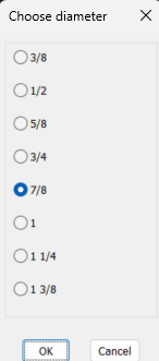

  9. This is my attempt at your task. Remembers last dia used. Adds circle matching bottom Quadrant point. (defun c:DG ( / diameters ans radius pt ) (setq diameters (list "Choose diameter" "3/8" "1/2" "5/8" "3/4" "7/8" "1" "1 1/4" "1 3/8" )) ; List of diameters (if (not AH:Butts)(load "Multi radio buttons.lsp")) ; loads the program if not loaded already (if (= lastBarDiameter nil)(setq lastBarDiameter 1)) ; this is needed to set default button (setq ans (ah:butts lastBarDiameter "V" diameters)) (setq lastBarDiameter but) ;; Store the last entered bar diameter ;; Set the layer based on the bar diameter (cond ((= but 1) (setq radius 0.375)(if (not (tblsearch "layer" "B3")) (command "LAYER" "M" "B3" "C" "10" "" "L" "CONTINUOUS" "" "p" "n" "" ""))) ((= but 2) (setq radius 0.5)(if (not (tblsearch "layer" "B4")) (command "LAYER" "M" "B4" "C" "14" "" "L" "CONTINUOUS" "" "p" "n" "" ""))) ((= but 3) (setq radius 0.625)(if (not (tblsearch "layer" "B5")) (command "LAYER" "M" "B5" "C" "30" "" "L" "CONTINUOUS" "" "p" "n" "" ""))) ((= but 4) (setq radius 0.75)(if (not (tblsearch "layer" "B6")) (command "LAYER" "M" "B6" "C" "40" "" "L" "CONTINUOUS" "" "p" "n" "" ""))) ((= but 5) (setq radius 0.875)(if (not (tblsearch "layer" "B7")) (command "LAYER" "M" "B7" "C" "50" "" "L" "CONTINUOUS" "" "p" "n" "" ""))) ((= but 6) (setq radius 1.0)(if (not (tblsearch "layer" "B8")) (command "LAYER" "M" "B8" "C" "70" "" "L" "CONTINUOUS" "" "p" "n" "" ""))) ((= but 7) (setq radius 1.25)(if (not (tblsearch "layer" "B9")) (command "LAYER" "M" "B9" "C" "99" "" "L" "CONTINUOUS" "" "p" "n" "" ""))) ((= but 8) (setq radius 1.375)(if (not (tblsearch "layer" "B10")) (command "LAYER" "M" "B10" "C" "110" "" "L" "CONTINUOUS" "" "p" "n" "" ""))) ) (setq radius (/ radius 2.0)) ;; Draw the circle at the specified point (setq pt (getpoint "\nSpecify the bottom point for the circle:")) ; Prompt for bottom point (setq pt (mapcar '+ pt (list 0.0 radius 0.0))) (command "circle" "_non" pt radius) ;; Set the current layer to 0-35 (or any default layer you want) ;(setvar "clayer" "0-35") ;; Clean exit (princ) ) Make sure you save Multi radio buttons in a support path or add the full path to the (load "Multi... Multi radio buttons.lsp
