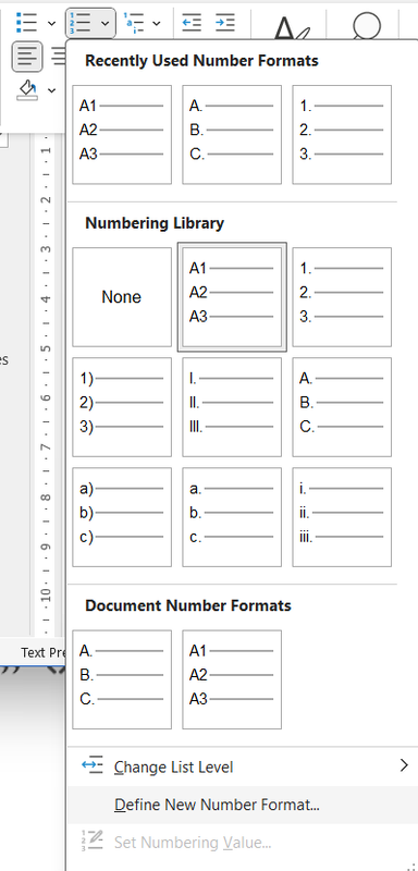

  1. Pretty much can do it manually in AutoCAD, or modify in Notepad as your text editor. If you do a list, bullet or which ever option, you should be able to start the entries, delete the A, bullet, number, then type A1, hit TAB, then it should word wrap to the tab stop, hit enter and then type the A2, hit TAB, so on and so forth. For Notepad, just create the LIST, BULLET, etc. in the internal editor, then use MTEXTED and change "internal" to "Notepad" then open the text and replace the A (or whatever) with A1, etc. You might be able to do it all in Word as the text editor as BIGAL shows and it remain. Doing all of this from memory, a search of the internet might bring up some better instructions and/or methods. I guess Autodesk thinks you can just use Word, etc. if you need to do this. I actually always do my lists manually as shown in my first method, never liked AutoCAD's.

  5. Using Word got close you can define a bullet Ax, took a couple of goes to get right. See the A1 A2 A3 at bottom. Use Define new number format. Us Aussies need to stick together up near Newcastle.
