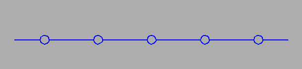

  2. The short answer is that you have specified too much of a gap. The CIRC1 shape at a scale of 0.04 is 0.08 in diameter. So the space (negative distance) should be 0.08, and you have specified 0.05+0.05=0.10 which gives the 0.02 gap. I suspect you are just beginning to learn about linetype definitions, but to correct your code, I would amalgamate the two line sections and also the two space sections into one each. You do not need an x dimension because the insertion point of CIRC1 is at the left hand quadrant point. This would give the code line to be:- A, .4,[CIRC1,ltypeshp.shx,s=.04],-0.08

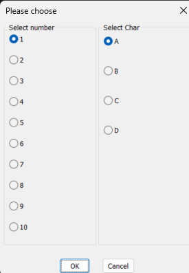

  3. Its not an answer to the question but does a 2 column radio button answer in just a few lines of code, it uses the library code Multi radio buttons 2 col, which it loads on demand. So just make 2 lists of what you want to see displayed in your dcl. Then use the cond etc. The code returns the displayed string or the button number selected a bit hidden but is there. There is sample code in the top of the code. Just a question why do you need 8 views ? Multi radio buttons 2col.lsp

  4. Maybe like this change values to suit. Note s=2.5 I think the circ1 is based on a 1 dia circle. The -5 gap = x offset. *JHOOK,JHOOKS ----O----O----O----O----O----O-- A,50,-5.0,[CIRC1,ltypeshp.shx,S=2.5,R=0.0,X=-5.0,Y=0.0]
