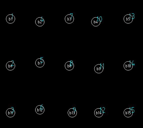

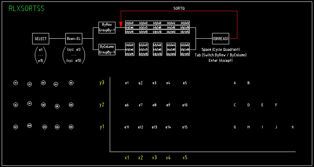

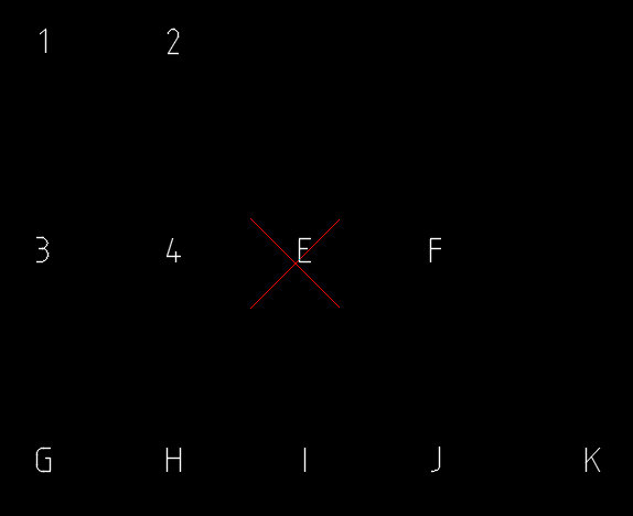

  1. Often I have to (ok , I want to) edit text (or blocks) directly on screen that are in a sort of table like order. Then it would be nice to be able sort it in rows & columns. In a perfect world all items would be spaced evenly. But we're not living in a perfect world now are we? Besides , that would be boring. Had something like this written a very long time ago but lately needed to be able to see if sorting order was correct before doing my stuff. So also for the fun of it I created mini app to sort things out (but not in my head) Anyways , added routine including a couple of tiny test functions. My own needs are a little bit more complex because need to be able to apply it on (sometimes specific) attributes in blocks too , but I leave the specialities for you little dragons Working is as follows: Select a group of simple text's (you can use attached drawing). The shape of your selection determines if you sort by row or by column (landscape means rows , portrait means columns. It uses the boundary size from 1st item in selection as a fuzz factor , some blocks are a little up , some a little down etc. This you can check by selecting the blocks on the left side of the sample drawing. After you made selection all insertionpoints (or text alignment points) the points are marked with blue number indication their rank on the social ladder. After this I use (grread) in a loop where you can use Tab to switch between ByRow & ByColumn , Spacebar to cycle in which Quadrant to start numbering and Enter means you're a happy human of planet earth. (C:t1) just shows you the list , (C:t2) you can replace the texts with another string. Rlx-Sort-SS.dwg RlxSortSS.lsp
