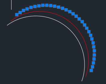

  1. With lisp, you can try this: (defun bulge_pts (pt_cen pt_begin pt_end rad sens / inc ang nm p1 p2 lst) (setq inc (angle pt_cen (if (< sens 0.0) pt_end pt_begin)) ang (+ (* 2.0 pi) (angle pt_cen (if (< sens 0.0) pt_begin pt_end))) nm (fix (/ (rem (- ang inc) (* 2.0 pi)) (/ (* pi 2.0) 36.0))) ) (repeat nm (setq p1 (polar pt_cen inc rad) inc (+ inc (/ (* pi 2.0) 36.0)) lst (append lst (list p1)) ) ) (setq p2 (polar pt_cen ang rad) lst (append lst (list p2)) ) (if (< sens 0.0) (reverse lst) lst) ) (defun c:arc2pl3D ( / ss AcDoc Space flag n ent dxf_ent name_layer lst) (princ "\nSelect arcs: ") (setq ss (ssget '((0 . "ARC")))) (cond (ss (setq AcDoc (vla-get-ActiveDocument (vlax-get-acad-object)) Space (if (= 1 (getvar "CVPORT")) (vla-get-PaperSpace AcDoc) (vla-get-ModelSpace AcDoc) ) ) (vla-startundomark AcDoc) (initget "Yes No") (if (eq (getkword "\nErase source arc [Yes/No]? <No>: ") "Yes") (setq flag T) (setq flag nil) ) (repeat (setq n (sslength ss)) (setq dxf_ent (entget (setq ent (ssname ss (setq n (1- n))))) name_layer (cdr (assoc 8 dxf_ent)) lst (bulge_pts (cdr (assoc 10 dxf_ent)) (polar (cdr (assoc 10 dxf_ent)) (cdr (assoc 50 dxf_ent)) (cdr (assoc 40 dxf_ent))) (polar (cdr (assoc 10 dxf_ent)) (cdr (assoc 51 dxf_ent)) (cdr (assoc 40 dxf_ent))) (cdr (assoc 40 dxf_ent)) 1 ) ) (cond (lst (vla-put-Layer (vlax-invoke Space 'Add3dPoly (apply 'append (mapcar '(lambda (x) (trans x (cdr (assoc 210 dxf_ent)) 0)) lst ) ) ) name_layer ) (if flag (entdel ent)) ) ) ) (vla-endundomark AcDoc) ) (T (princ "\nEmpty selection")) ) (prin1) )

  2. something like this (defun c:doit ( / doc ep i modelspace mp obj p points polyobj prms sapoints sp util) (vl-load-com) (setq doc (vla-get-activedocument (vlax-get-acad-object))) (setq util (vla-get-utility doc)) (vla-getentity util 'obj 'ip "\nSelect Object: ") (setq prms '()) (setq sp (vlax-curve-getStartParam obj)) (setq ep (vlax-curve-getEndParam obj)) (setq mp (/ (- ep sp ) 31)) (setq i mp) (setq prms (append prms (list sp))) (repeat 30 (setq sp (+ i sp)) (setq prms (append prms (list sp))) ) (setq prms (append prms (list ep))) (setq points '()) (foreach p prms (setq points (append points (vlax-curve-getPointAtParam obj p))) ) (setq sapoints (vlax-make-safearray vlax-vbDouble (cons 0 (-(length points)1)))) (vlax-safearray-fill sapoints points) (setq modelSpace (vla-get-ModelSpace doc)) (setq polyObj (vla-Add3DPoly modelSpace sapoints)) )
