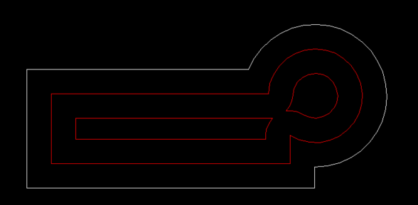

  4. Difficult task as you have implied different rules within the shapes I think its because you have done it manually. If you were to do offset of shape and insert along that could be done with multiple offsets. Look at your right hand shape.
