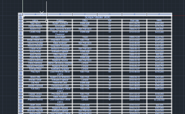

  9. spam? you can use Python and BeautifulSoup import traceback from pyrx_imp import Rx, Ge, Gs, Db, Ap, Ed import wx import requests from bs4 import BeautifulSoup as bs import pandas as pd # sample source https://www.scraperapi.com/blog/python-loop-through-html-table/ def scraper9000(): url = "https://datatables.net/examples/styling/stripe.html" response = requests.get(url) soup = bs(response.text, "html.parser") table = soup.find("table", class_="stripe") data = { 'Name': [], 'Position': [], 'Office': [], 'age': [], 'Start date': [], 'salary': [], } for employee_data in table.find_all("tbody"): for row in employee_data.find_all("tr"): data['Name'].append(row.find_all("td")[0].text) data['Position'].append(row.find_all("td")[1].text) data['Office'].append(row.find_all("td")[2].text) data['age'].append(row.find_all("td")[3].text) data['Start date'].append(row.find_all("td")[4].text) data['salary'].append(row.find_all("td")[5].text) return data def PyRxCmd_doit(): try: db = Db.curDb() df = pd.DataFrame(scraper9000()) table = Db.Table() table.setDatabaseDefaults(db) table.setSize(df.shape[0]+2, df.shape[1]) table.setTextString(0, 0, "Scrape Master 9000") headers = df.columns.values.tolist() datas = df.values.tolist() for col, value in enumerate(headers): table.setTextString(1, col, "{}".format(value)) for row, data in enumerate(datas): for col, value in enumerate(data): table.setTextString(row+2, col, "{}".format(value)) model = Db.BlockTableRecord(db.modelSpaceId(), Db.OpenMode.kForWrite) model.appendAcDbEntity(table) except Exception as err: traceback.print_exception(err)
