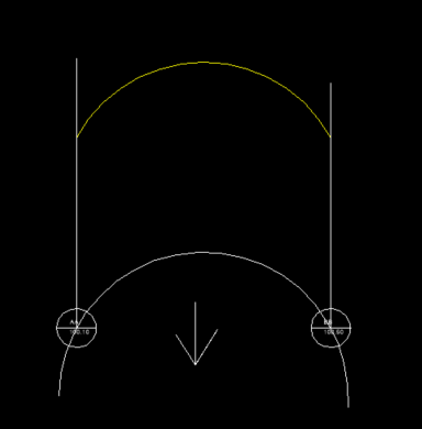

  2. Because you want a yellow pline section working with curves in a pline it is difficult, a quick workaround is copy the pline say to right 200 then adjust the 2 points chosen points X+200, trim the pline both ends, change its layer so becomes yellow, move it back -200, all done. Removes all the headaches of trimming and remaking plines. No Code at this stage just a suggestion. Image shows idea.
