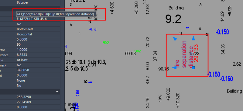

  1. All you really need to do is convert the selection set over to vla-object and pull the textstring value. with vla-get-property this strips out the formatting (like you linked) usually don't use mtext so my bad. on the coding. noticed my unhide command was missing a * so it was only finding text and not mtext. updated the code to only process the selection set once since everything is being converted over to vla-object names at the start then adding them to a list if a number is found in the string. processing the list at the end. Probably be negligible in time but it ends up being more effectuate. This will find any mtext and text with a number in HideTextwNumbers.lsp

  4. I think part of the problem is, that the content of the text is formatted, and therefore it will find numbers in every single instance

  5. Oops - yeah, mine wasn't actually working correctly either. My wcmatch pattern was wrong in a few ways. Unfortunately, I don't know wcmatch good enough to make it work, and I am not even sure (wcmatch) will do the job. I think regular expression is the way to go.

  6. Absolutely perfect! Thank you very much for your help.
