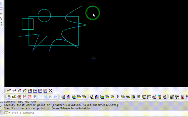

  10. (defun c:XDTB_DWGCUT (/ dynpt e lastpnt myerr olderr pts ss ss1 tf) (defun _callback (dynpt) (xdrx_entity_move ss lastpnt dynpt) (setq lastpnt dynpt) ) (defun _move (ss) (setq lastpnt (trans (xd::geom:get9pt ss 5)1 0)) (xdrx_pointmonitor "_callback" ss) (initget 1) (getpoint (xdrx-string-multilanguage "\n插入点:""\nInsert Point:")) (xdrx_pointmonitor) ) (defun myerr (msg) (princ "\n*cancel") (xdrx_end) (vl-cmdf ".undo" 1) (setq *error* olderr) (princ) ) (xdrx_begin) (setq olderr *error*) (setq *error* myerr) (setq pts nil) (if (setq e (car (xdrx_entsel (xdrx-string-multilanguage "\n请拾取裁剪边界<退出>:""\nPlease pick the cropping boundary <Exit>:") '((0 . "lwpolyline,circle,ellipse,spline")) ) ) ) (progn (setq tf (xdrx-document-safezoom e)) (setq pts (xdrx_getsamplept e) ss (ssget "cp" (xd::pnts:wcs2ucs pts)) ) (if (setq ss1 (xdrx_geom_clipboundary ss e t t)) (progn (if tf (xdrx_document_zoomprevious) ) (ssadd e ss1) (_move ss1) ) ) ) ) (setq *error* olderr) (xdrx_end) (princ) ) [XDrX-PlugIn(83)] DWG cutting (theswamp.org) https://www.theswamp.org/index.php?topic=59019.0
