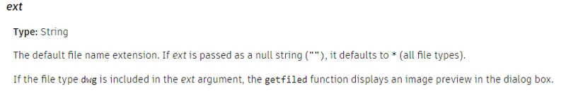

  3. FYI - (getfiled...) will only display a preview image when DWG is used as the extension. See link: https://help.autodesk.com/view/ACD/2024/ENU/index.html?guid=GUID-AD65DF88-5218-4655-B877-B4D33B9FB6D1
