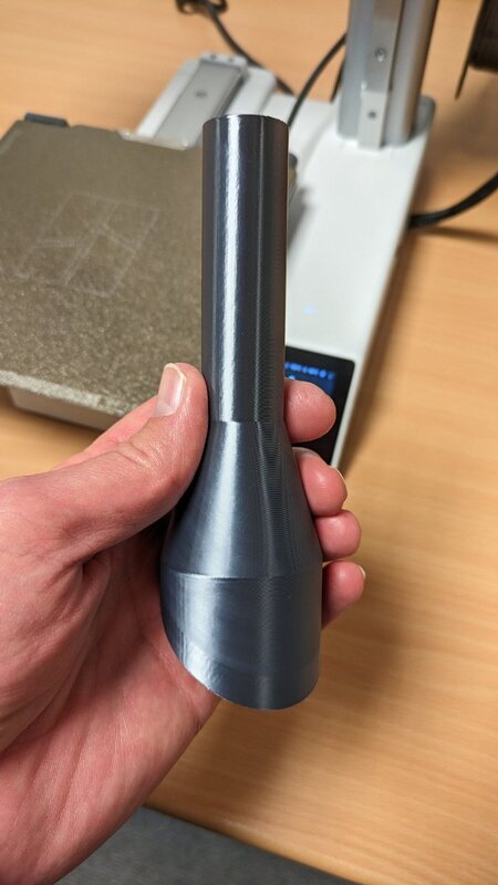

  10. Just as an update to this thread, here's a print showing just how smooth it looks now...

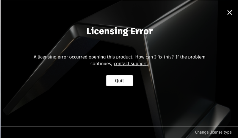

  17. I got licensing error last week and again this morning. I sent it all to IT, but haven't heard back.

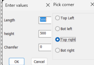

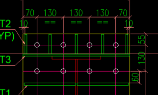

  20. It can be done fairly simply but it needs your help, as the objects are on same layer this complicates things so 1st step is change dims to a new layer, 2nd step change plines to a new layer. Once this is done can just isolate 2 layers the text and the pline. Its a simple look for text say ST1 then search above it for a pline, can then simply block that object with correct name. So try editing the dwg making common objects on layers and code will be easy to do. Re post new dwg. If you want as blocks why not draw correct 1st up I would use a lisp to draw looks like 2 patterns, a triangle and a chamfered corner rectang, can do which way up and which corner pretty easy. As part of lisp makes block. The dwg should really be using lots of layers not everything on layer 0. But I would have lisps for a lot of what your drafting like slots. They could be dynamic blocks, width and length, bolt holes patterns and so much more.
