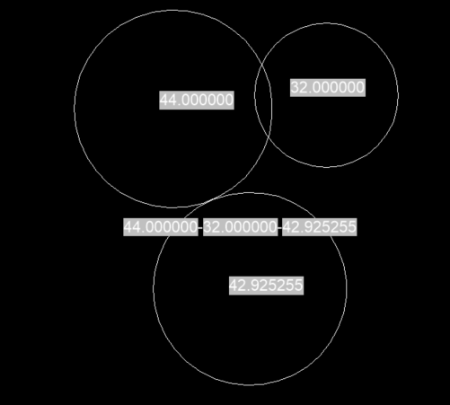

  2. It may be easier to try this expects that you are picking 3 field text objects, expects that the destination mtext exists. ; pick multi mtext and paste into another mtext ; By AlanH March 2024 (defun c:wow ( / txt1 txt2 txt3 obj4) (setq txt1 (vlax-ename->vla-object (car (entsel "Pick 1st text object ")))) (setq str (strcat "%<\\AcObjProp Object(%<\\_ObjId " (itoa (vla-get-objectid txt1)) ">%).TextString>%" ) ) (setq txt2 (vlax-ename->vla-object (car (entsel "Pick 2nd text object ")))) (setq str (strcat str "-" "%<\\AcObjProp Object(%<\\_ObjId " (itoa (vla-get-objectid txt2)) ">%).TextString>%" ) ) (setq txt3 (vlax-ename->vla-object (car (entsel "Pick 3rd text object ")))) (setq str (strcat str "-" "%<\\AcObjProp Object(%<\\_ObjId " (itoa (vla-get-objectid txt3)) ">%).TextString>%" ) ) (setq obj4 (vlax-ename->vla-object (car (entsel "Pick destination text ")))) (vlax-put obj4 'textstring str) (princ) )
    1 point
