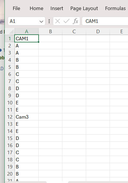

  10. Can write direct to excel. As you pick text puts value into Excel twice a bit odd request but not a problem. Try this asks for label then text use Enter to exit note need 2 enters to exit totally. ; simple text to Excel ; By AlanH March 2024 (defun c:wow ( / col txt) ;; Thanks to fixo ;; ;; = Set Excel cell text = ;; ;; ;; (defun xlsetcelltext ( row column text) (setq cells (vlax-get-property (vlax-get-property myxl "ActiveSheet") "Cells")) (vl-catch-all-apply 'vlax-put-property (list cells 'Item row column (vlax-make-variant (vl-princ-to-string text) vlax-vbstring))) ) (if (= myxl nil) (setq myxl (vlax-get-object "Excel.Application")) ) (if (= myxl nil) (progn (setq myxl (vlax-get-or-create-object "Excel.Application")) (vla-put-visible myXL :vlax-true) (vlax-put-property myxl 'ScreenUpdating :vlax-true) (vlax-put-property myXL 'DisplayAlerts :vlax-true) (vlax-invoke-method (vlax-get-property myXL 'WorkBooks) 'Add) ) (princ "Excel open") ) (if (= row nil)(setq row 1)) (while (/= (setq txt (getstring "\nEnter new label Press Enter to exit " T)) "") (xlsetcelltext row 1 txt) (setq row (1+ row)) (while (setq txt (entsel "\nPick a text or Enter to exit ")) (setq txt (cdr (assoc 1 (entget (car txt))))) (xlsetcelltext row 1 txt) (setq row (1+ row)) (xlsetcelltext row 1 txt) (setq row (1+ row)) ) ) ; (if (not (vlax-object-released-p myXL))(progn(vlax-release-object myXL)(setq myXL nil))) (princ) )
