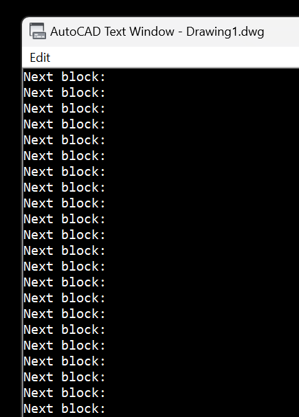

  1. Steven P, I could not get yours to work <for me> unfortunately. Seems like it got stuck in a loop. (princ "\nNext block: ") My test was this and a crossing gave me this.. <I had to cancel to get out of the loop> I do appreciate it! And the help elsewhere!!
