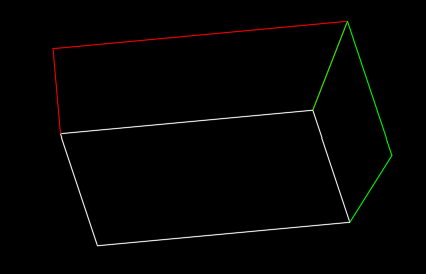

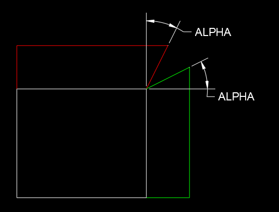

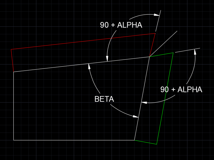

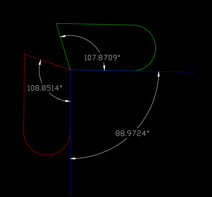

  11. @vanowm I've modified the formula to handle corners that are not 90°. Here's the revised formula for theta, the bend angle. THETA = acos(tan(ALPHA) / tan(90 - BETA/2)) Here's a LISP program to calculate THETA (defun c:foldangle (/ alpha beta theta) ;; calculate fold angle lrm 2/14/2024 (setq alpha (getreal "\nEnter alpha (deg): ")) (setq beta (getreal "\nEnter beta (deg): ")) (setq theta (acos (/ (tan (/ (* alpha pi) 180)) (tan (- (/ pi 2.) (/ (* beta pi) 360))) ) ) ) (setq theta (/ (* theta 180.) pi)) (princ "\n THETA = ") (princ theta) (princ) ) ;; ArcCosine - Lee Mac ;; Args: -1 <= x <= 1 (defun acos ( x ) (if (<= -1.0 x 1.0) (atan (sqrt (- 1.0 (* x x))) x) ) ) ;; Tangent - Lee Mac ;; Args: x - real (defun tan ( x ) (if (not (equal 0.0 (cos x) 1e-10)) (/ (sin x) (cos x)) ) ) Note that in your drawing the angles for the tabs are not equal. They should be.

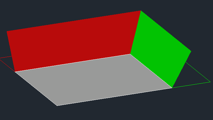

  15. Given a flat pattern that looks like this. The angle theta needed to rotate each tab up about it edge so that the ends are coincident is: THETA = ACOS(TAN(ALPHA)) Which yields the following.
    1 point
