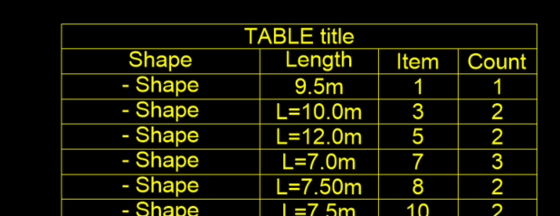

  14. Found some time and found a few more things to fix. Need sort on length, need to check for 7.5 & 7.50, fix ID number. So will be back. Please let me know if that is what your looking for that is important. Also fixed number of decimals to 2 for all lengths 8m becomes 8.00m 8.5 now 8.50. In both beams and table.
    1 point
